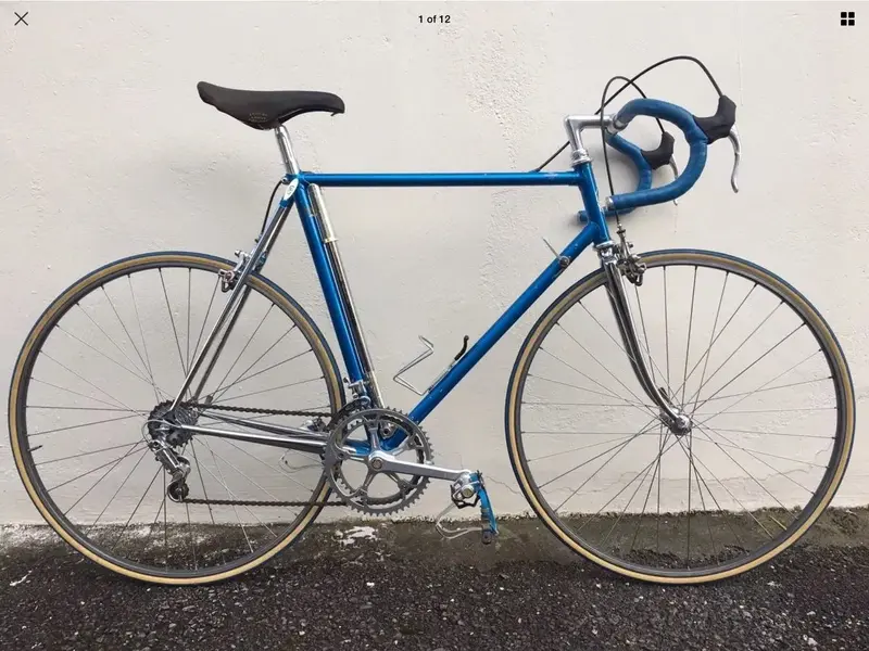

The group is gonna take some work. There’s a bit of corrosion to deal with on the chrome parts. Looks low mileage but been standing a while
Well it has arrived from Spain in one piece :D
The good news is that most the groupset will clean up fine
There is a nice original suede Concor supercorsa saddle with no rips or scars
Mavic G40 rims in good condition laced to the 50th hubs and the spokes are good
Cinelli bars and stem are unmarked
The headset looks like its been nowhere near a spanner beyond when it was fitted
There are some negative points:
The hoods have been replaced with C-Record type which don't fit - these will need replaced
there's one dustcap missing from a pedal
The font skewer lever is beyond saving I think but I have spares
The frame needs paint, decals and probably chrome. I may move the frame on
All in all it looks little used when you look at the chainrings and brake blocks - just a shame that it has not been stored carefully

Is the frame tubing Columbus SL or KL ? I have a Pinarello Prestige S with Columbus KL tubing and all internal cable routing.The 54cm frame i have is clearly lighter(1670gr) than comparable frame with Columbus SL(1900+gr) tubing set.
Pretty certain it is SL
