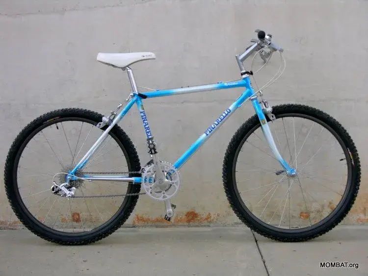

[attachment=0]small.jpg[/attachment]I just looked, the models shown are the Antelllo, I saw the black Cristalo model here and got inspired to go for that, though I fear the Giovo doesn't
have the beautiful fork crown detailing

though I'd go for white decals
the paint work on the pina mtbs seems to bee sold, and not metallic/mercurial/chromovelato orientated like on the road bikes of that era

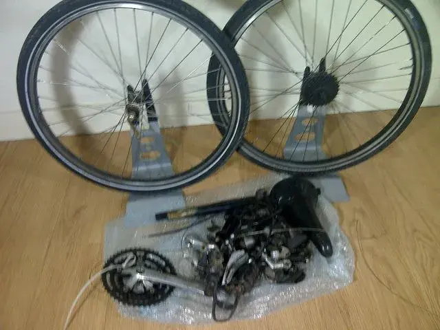

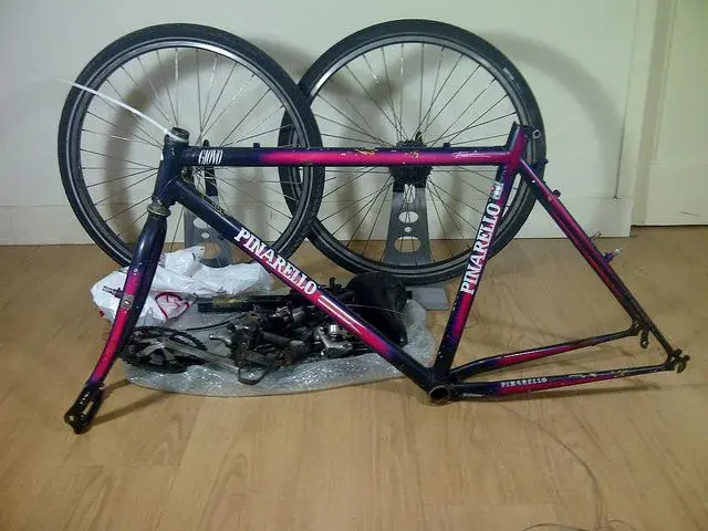

[attachment=1]8620238680_627b736f39_z.jpg[/attachment][attachment=0]8620238624_870c9f49f8_z.jpg[/attachment]finally arrived

not sure it too small :facepalm:
I usually ride road with 53-54 cm tt, as has this, but the seat tube is 50 c-t

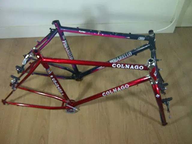

here's a comparison with my other mtb frameset

but in this context, i think the seat tube isn't an issue

Mtb frame sizes will always be smaller than road frame sizes. I usually concentrate on top tube length and reach.
I am an mtb'er who recently started road riding; my road frames are all around 56cm, with 56cm top tubes, where as my mtbs are all around 18" frame (45cm) with 21.5" (53cm) top tubes. I obviously ride with longer stems on my mtb's than my road bikes.
Strickly speaking as I am 6'1" (1.81) tall, both are too small, but I seem to manage fine :wink:
Those are two very nice frames, I look forward to seeing them both built up (and covered in mud).
