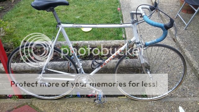

Picked this up last week locally for a very reasonable amount.
It will be my first foree into a road bike and looks like a good starting point.
The first half serial number under bb are missing but from what I've managed to find is around 1980, judging by mafac centre pull brakes and paint.

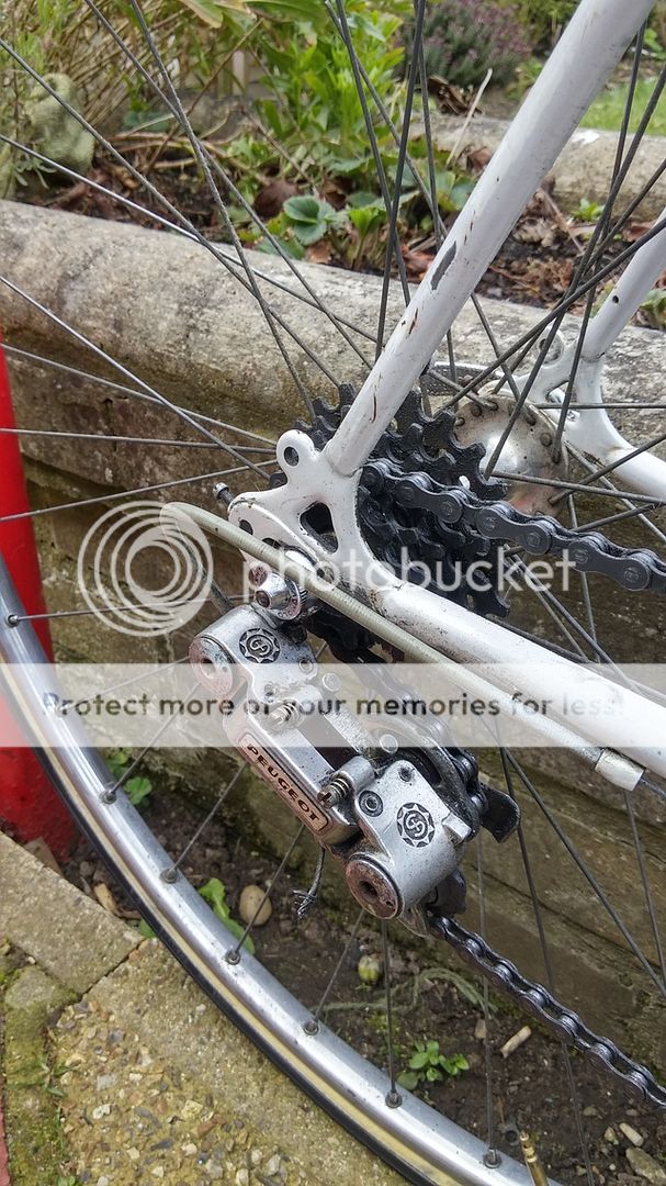

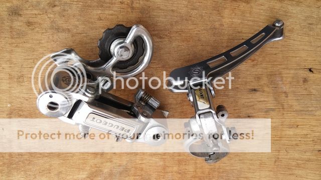

Seat post, derailleurs and shifters all original simplex.

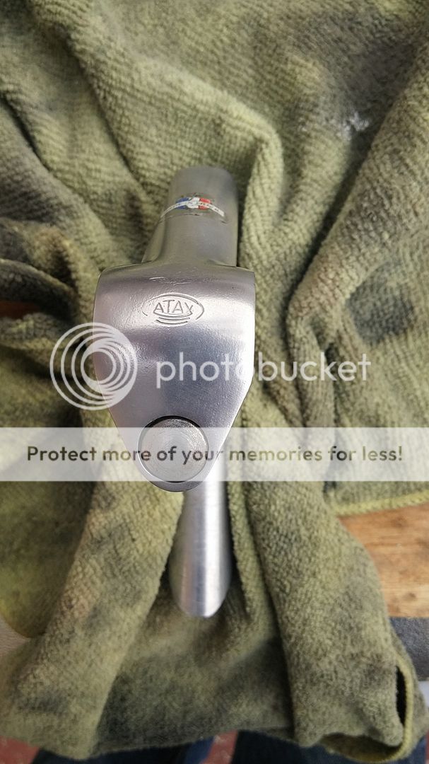

Atax bars and stem present. Campagolo skewers & hubs with mavic rims. knackered tubular tyres.
Paint work needs work, one of the previous owners decided to rattle can paint over some rusty spots and very badly at that. Had a quick rub with some nail varnish remover so Will strip the old girl down and see what's under there.
As my first road bike I think I'll hang onto her and may well get it re powder coated with new decals.
Cables, New seat and bar tape and be a happy bunny.
That looks great! Loving the Peugeot-branded derailleur and whatever those eyeletted rims are.

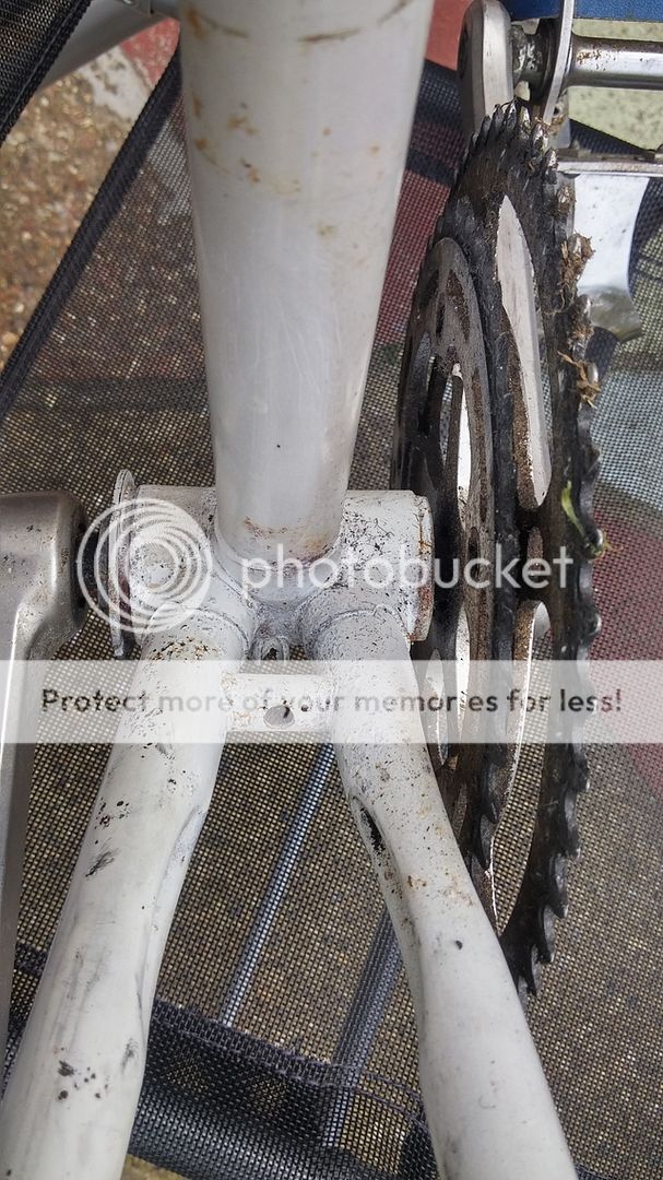

Not much of an update really....just had some time to start stripping the old girl down.

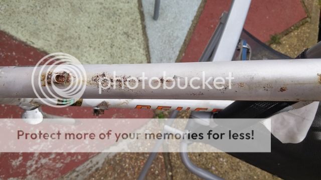

Serial number above begins with 0 so definately 1980. Also see in the picture some of the rust spots and quality paint touch up previously.
Going to have to get the paint redone, whether powder coat or paint is better I'll have to investigate yet.

Jockey wheels look bit worn but apart from cables, tyres, bar tape and more age related sadle that's all it should need.

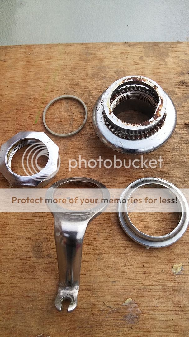

The races in the headset need replacing
But being french the stem is 22mm but I believe I could use a 1" headset but with the light race locknut on?
Would like to replace with a suitable age wise item.

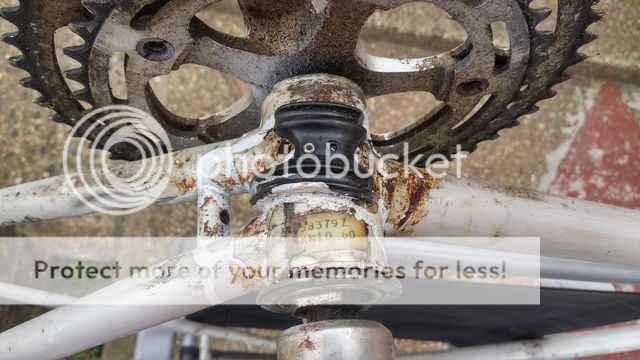

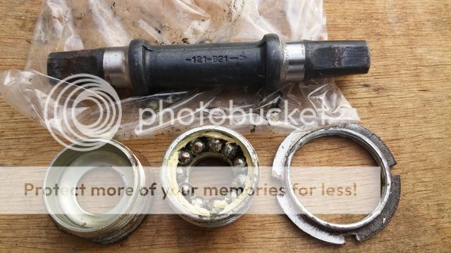

On removing bottom bracket the fixed cup has left hand thread.....so not french.
But from early 80s it could be Swiss thread....:/ ??
Apparently Swiss thread tend to have a groove round the fixed cup circumference as in the example below.
Mine doesn't have this groove so I'm hoping it's British cups on the pkn.......maybe you guys would know better.

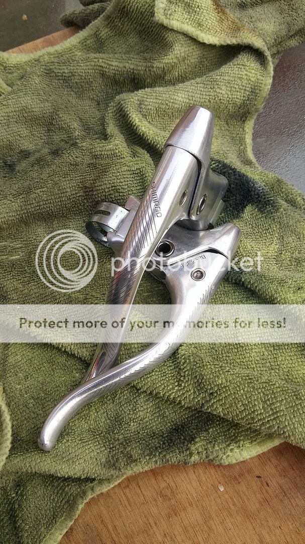

I've got stuck into the components as well, cleaning and regressing as I've gone along.
Most parts so far have come up fairly well.
Looking for parts and possible pricing....if cups are Swiss can I use a non threaded yst/ velo orange style bottom bracket ?
What if it's English can I put a sealed cartridge bottom bracket in there (121mm req'd) or replace with cups again.

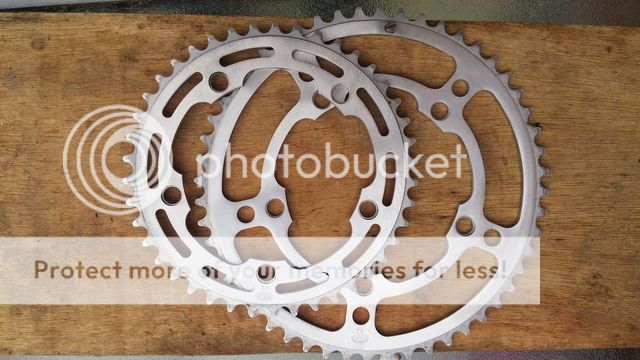

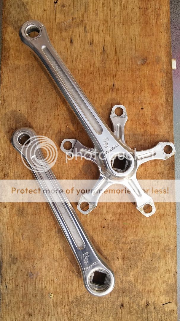

Think crankset is nervar..... Peugeot logo only.
Is something like the stronglight 106 suitable in keeping with an early 80s french built bike?
