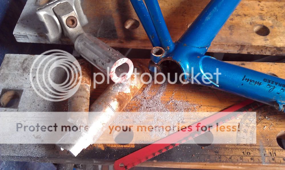

The seatpost was completely welded into the seat tube! After cuting through the post and clamping it in the vice to free it, the post fractured, and started to fall apart. :o Rather than apply any adddtional force or twisting, i decided that i enjoyed the first cut so much, i'd cut it again! :x
Thankfully it eventually came out, but not without a good fight!

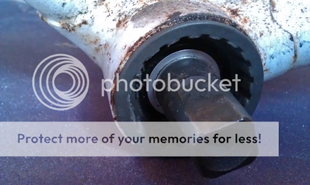

Now i have to start on the bottom bracket! :( The plastic cup (great idea someone at Shimano :roll:) is so well stuck that the tool simply stripped the teeth off....so it looks like the Pug will have to have another operation :x

Those simplex seatposts are pretty thick aren't they! Good job with that. What have you got in mind for getting the BB out? You could try melting the plastic threaded section using a soldering iron or small blow torch (like those one's you get for Creme Brule's!). Bodgetastic but with care it can be enough to muller it sufficiently to be able to lever and bash it out of the BB shell. Either way its a ball ache...
Couldn't be as big a ball ache as that seat post! :lol: not sure on a plan of attack, soldering iron would be as much heat as I'd like to apply, thinking maybe a dremmel, drilling and cutting gently. By the way, any idea what size of seatpost is in the Perthus? 26.4?

It's become a bit of a battle, me and the Peugeot, i've now got a stuck bottom bracket :x Its not going down without a fight, but i'm really determined now to get it totally stripped and refurbished! :D
Progress has been slow recently, the bottom bracket is still stuck (welded) in the frame :x gentle persuasion moves up a gear or two this weekend :twisted:

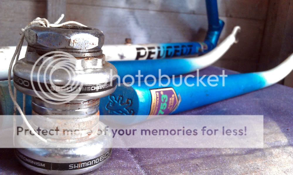

On a positive note, the forks are free with incident :D .....

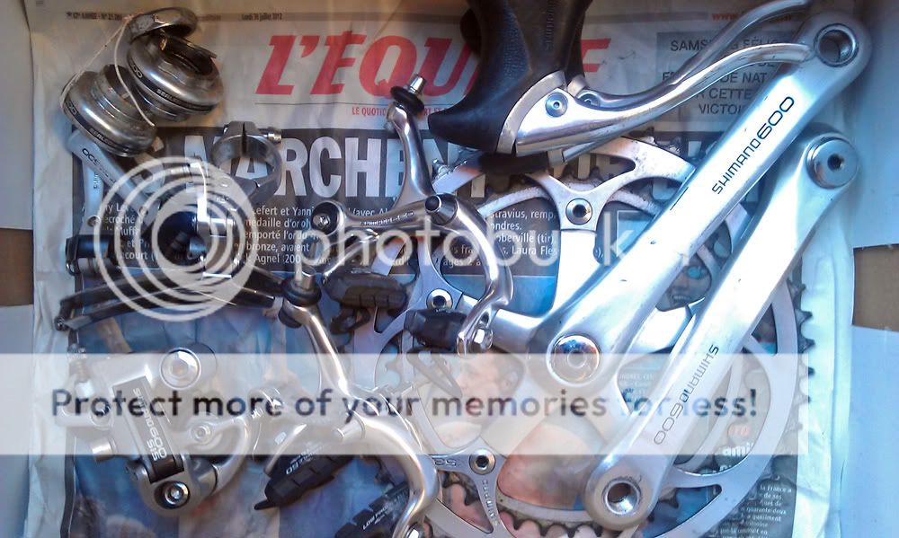

....and i have loads of 600 parts (Cheers Greg) to make up a complete groupset.
Just need a seat post & bottom bracket now :roll:
