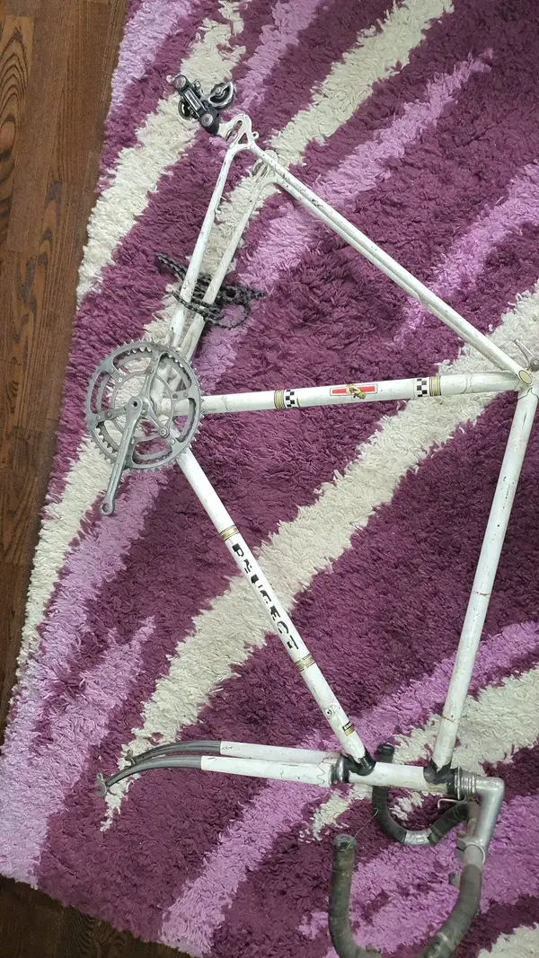

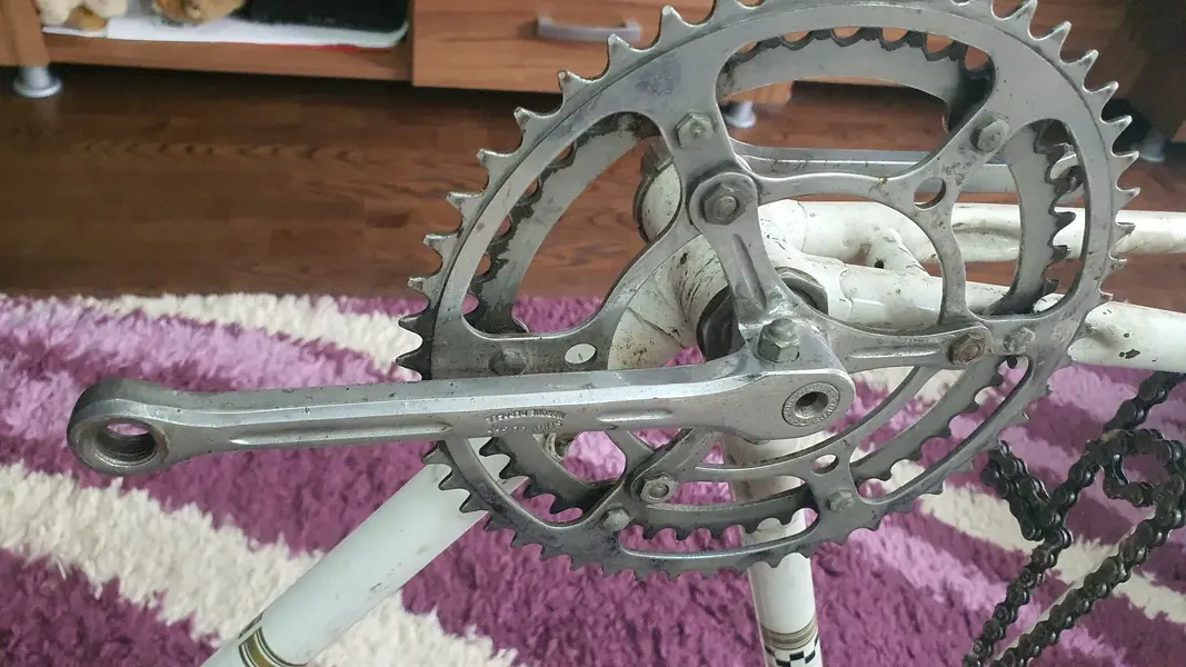

Few time ago i was found to my country house a 1975 Peugeot PA10L , stored in a box , all original, except saddle, seat post, chain, freewheel and 2 break pads with holders. Bike was staying there for like 15 years or more.
Equipment :
- transmision is a Stronglight cottered cranks , 52/45
- front and rear derraileur - Simplex prestige
-Simplex friction shifters
- Wheels are Mavic with tubular tires,
- Notmandy high flange hubs
- Simplex quick release
- Casset was Atom 14-21 , now running a Shimano UG 14-24
- break - Mafac Racer and Mafac Course break levers - white
- Ava stern and handlebar
- Liotard pedals and Hristophe toe clips
What i intend to do - restore and put it back on the road. Was running excelent when i use it. Need to change shifters and break cables, break pads and try to find a high gear Sunrace or Atom freewheel, chain and tubulars tires.
Some photo - disasemled , like i was finding , ready to be cleaned :
20220926_094701.jpg 20220926_094531.jpg 20220926_094548.jpg 20220926_094847.jpg 20220926_100015.jpg 20220926_095523.jpg

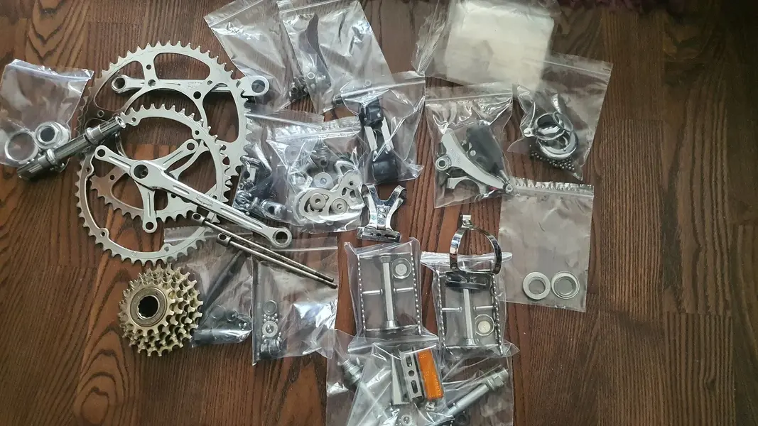

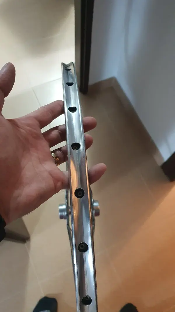

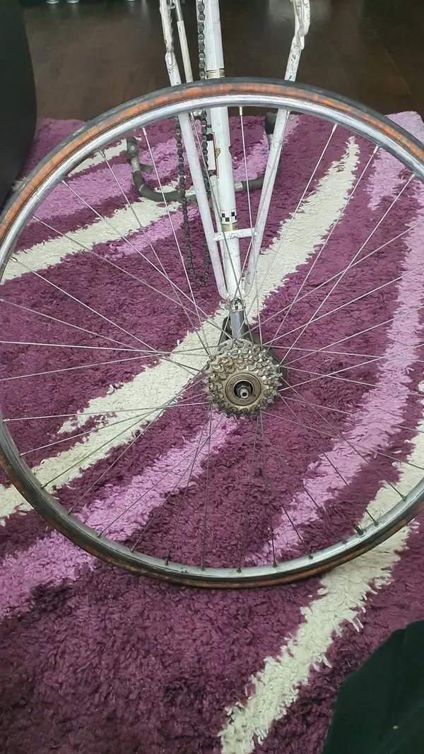

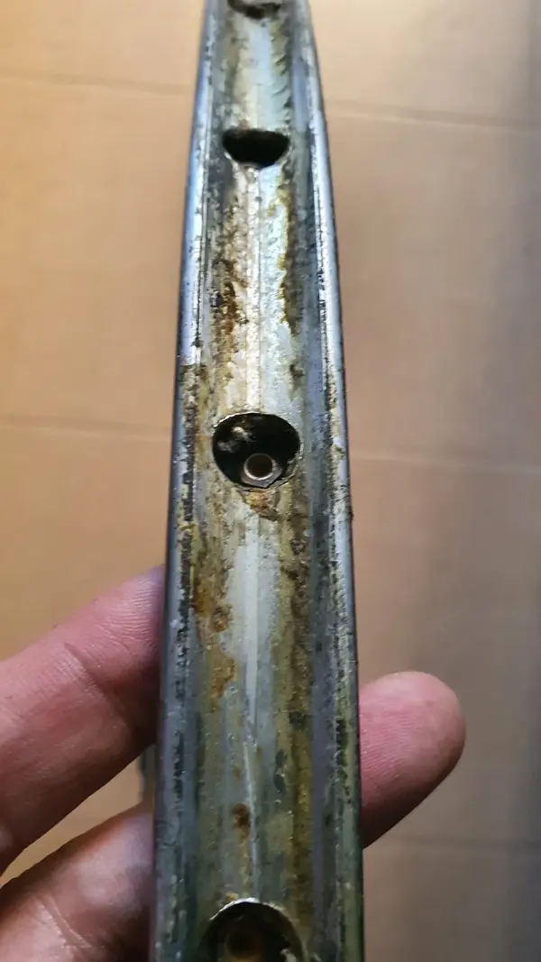

Progress so far : I have started with the weels - remove old tubular tires and glue cleand :
before:
20221003_175541.webp after :
Wheels are ready for final stage polish , instal new tubulars and maybe new freewheel - hope someone have one for sale :)

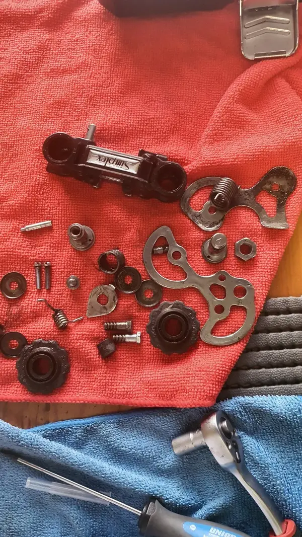

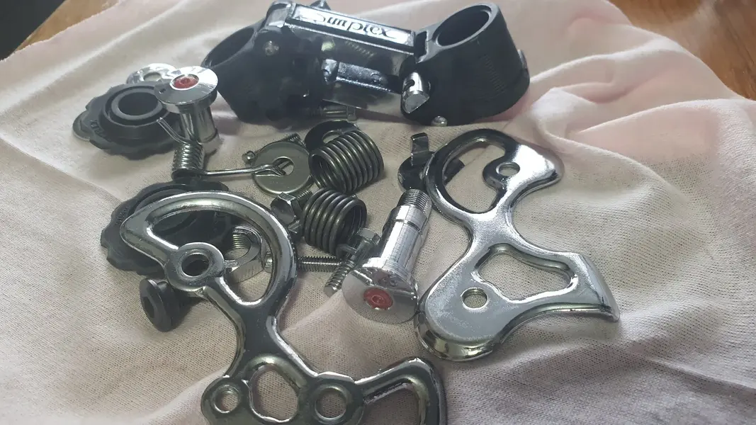

Next one was rear and front derraileur : full striped , degrease and cleaned :
Ready for pack and reasemble :
Use some degreaser and Autosol polish paste .

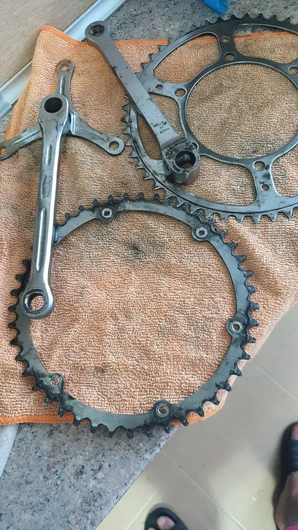

And now i am here , clean a few more parts , packed and ready for final stage machine polish , then reasemble :
Cheers !
Verry messy job, i have cleaned the kitchen 2h after 😅

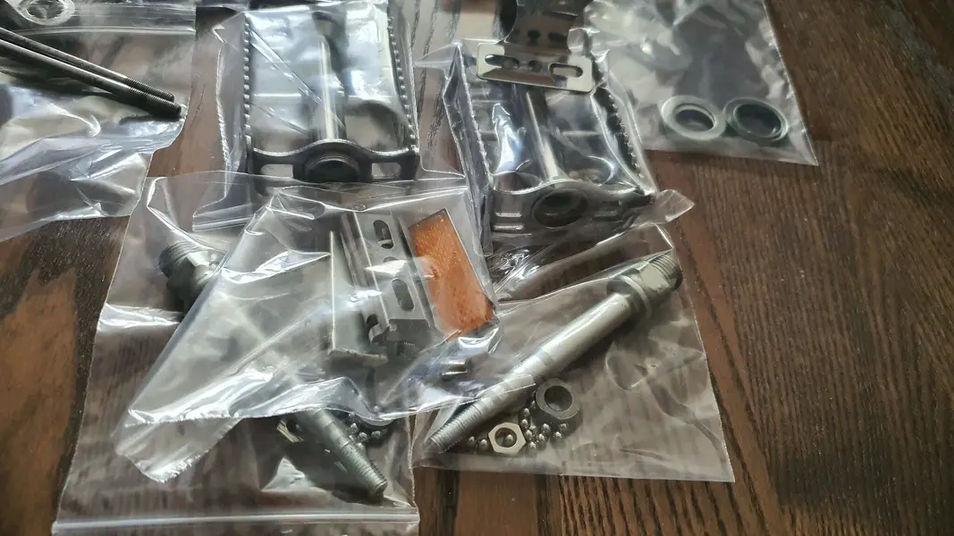

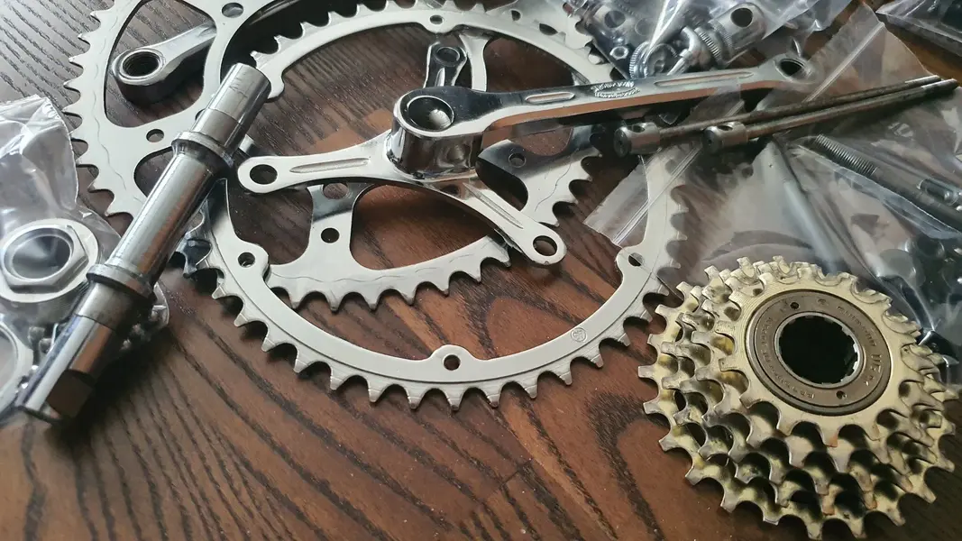

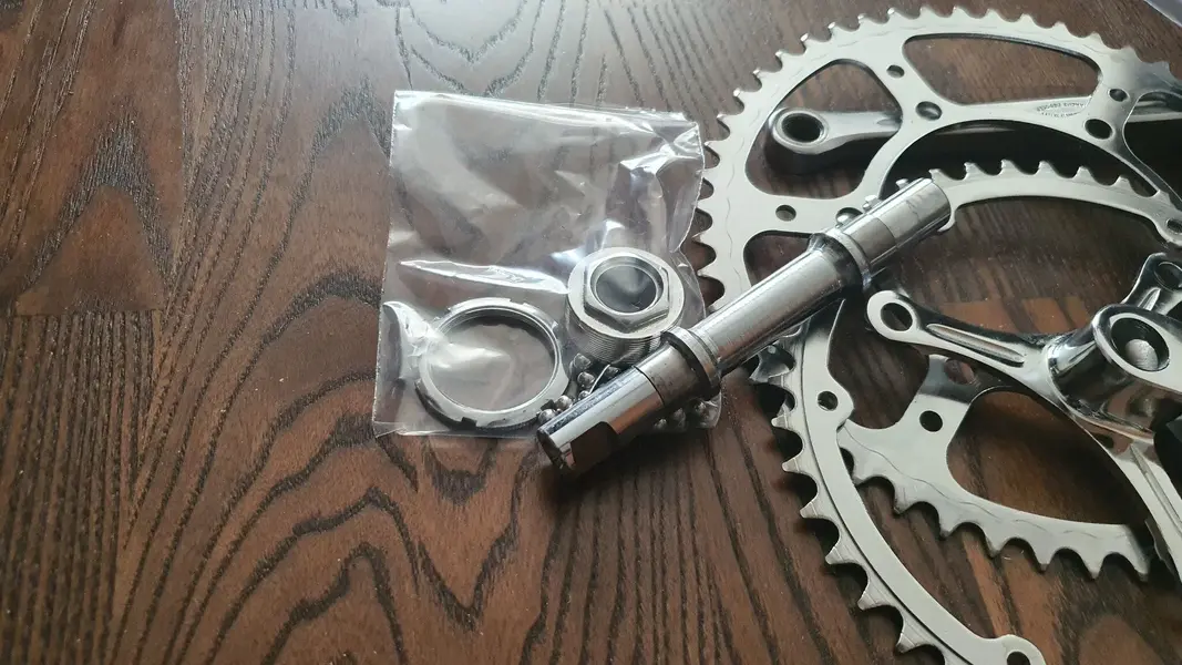

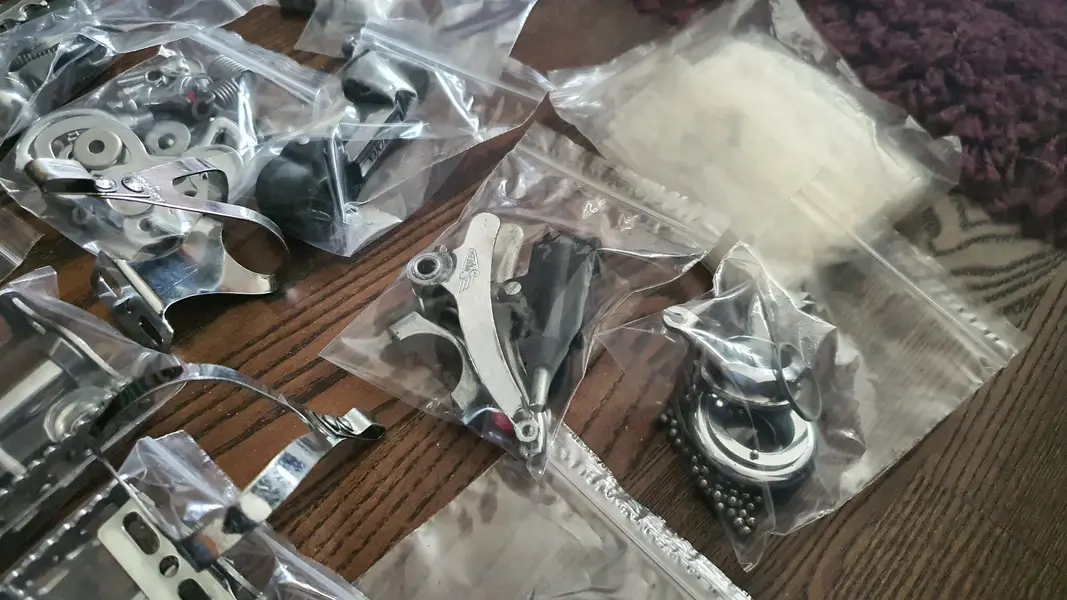

In the end : all packed :
20221007_131939.webp 20221007_131943.webp 20221007_131952.webp 20221007_132000.webp
Next stage is to remove few surface rust from chromed parts, bolt and nuts and then go to last stage machined polish. For this one i need to find a friend with that kind of machine 😅.

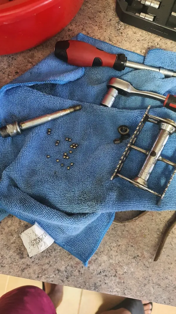

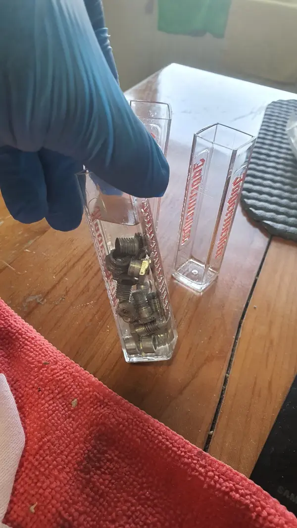

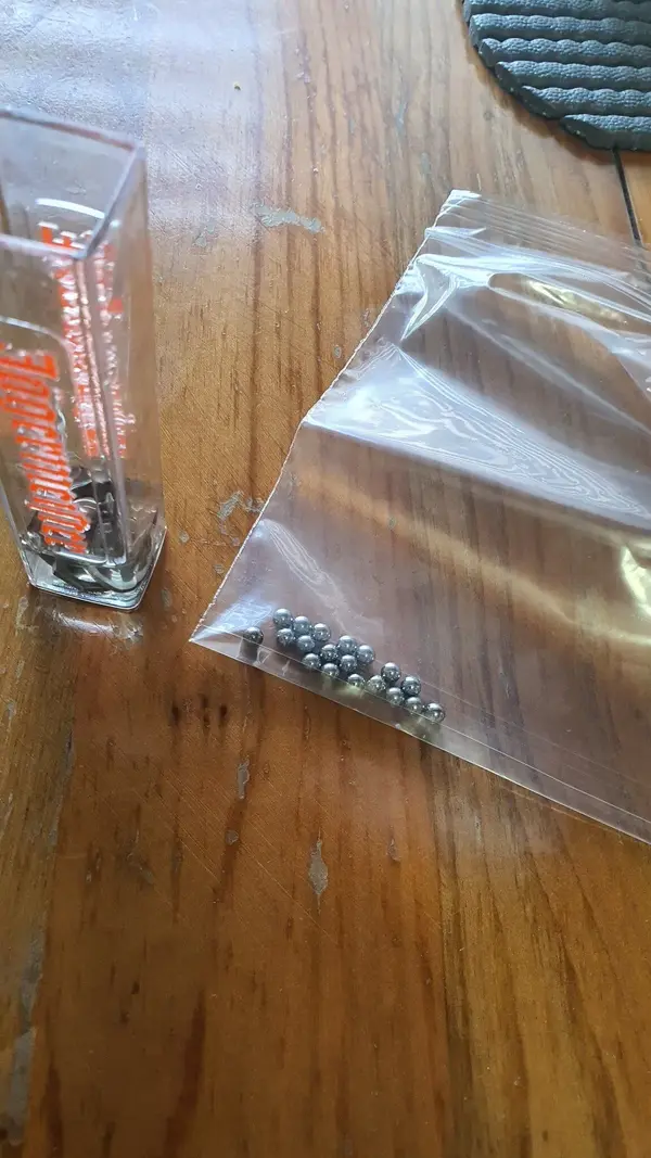

Problem found so far : headset bearings balls need to be replaced and i miss 1 washer from Simplex shifter 🥺 - if i will buy a few washers and the piece i miss - 40$ ...from France - this is the " advantage " you want vintage parts all originals.
Bearing balls not in good condition:
