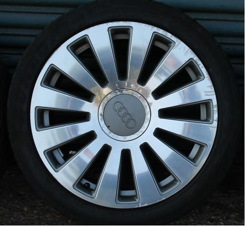

Not a bike frame but a car wheel, this one I polished last year, just to give you an idea of what's involved
I removed the powder coating using 400 grade sandpaper on an air powered DA sander, then using 400 grade wet & dry I cleaned up the bare wheel face, then 1200 grade wet & dry to give a finer finish and eventually finishing with 2000 grade wet & dry.
I start to polish up the wheel using Solvol Autosol and the results were encouraging although not as good as I needed, so I spent another hour with the 2000 grade wet & dry to get a really smooth finish.
Click images for full size

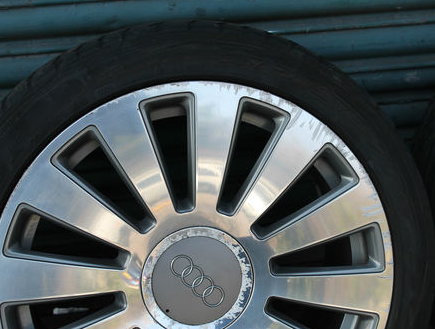

This is the tiny marks that must be sanded out
The aim is to have a uniform even finish
Once prepared it took a maximum of 10 minutes to polish the wheel using the rotary and 10 minutes to finish by hand
The alloy used in wheel making is not completely smooth, so a complete mirror finish would be almost impossible, plus if it was a mirror finish the lacquer would not adhere to it properly, so I am happy with my efforts. Just need to get it to the paint shop now for the painter to do his bit.
