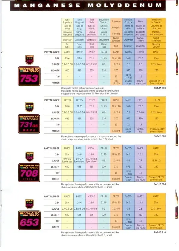

The bit I can't recall is whether Peugeot used the metric sized tubes on 653, in which case the Raleigh info is irrelevant as they used imperial sizes. I tried the tables in the Tony Oliver book, but they don't cover metric gauges.

The external seat tube size on mine is 28mm not 28.6.
I think that's the metric size tubing. Don't quote me on this, but certainly Peugeot used metric sized Reynolds tubesets at some times. What I have been unable to find out is whether they did them in 653. Certainly 753 was available in metric.
28.0 stepped down from the imperial size 27.2 seatpost is 26.8, which fits the upthread evidence from Chat Noir.
Here are some Reynolds catalogues from around 1992 that will provide further clarification and refer to the different gauges for 753 'over time'. The one that sets out the tube specifications says that metric tubesets were also available on request. These also clarify the 753 stays question, although looking in the bottom bracket and seeing the silver solder is very reassuring!
These images have been posted before. I like the old Reynold's tubing but my particular favourite is 731os on which I found I could happily do long multi-day rides. Sadly a crack has put paid to further activities until such time as I can get over to Bob Jacksons in Leeds and allow Donald to have a long look and consider what, if anything, could be done (this was originally the result of an accident where I was knocked off the bike by an oversized motorhome near the top of the Bealach na Ba, repaired at BJ's but now a crack has appeared ..).
