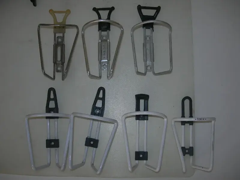

As for the cages - TA did the top of the range cages at the time. They were a bit heavier but the pro's swore by them. I can't think of an alternative that would look as cool, to be honest. I got the current Blackburn alloy ones in silver as they are light and not offensively modern looking, but get the TA chromed steel ones if indeed you can find them.

Have a large stash of bottle cages so will dig that out and see if any fit the bill!

So I had a quick look, and have what's in the pic:
- steel or chromed with yellowed plastic part. Marked "Made in Italy" but nothing else
- Alloy Cobra
- Alloy TA
and 4 white ones that would look OK but are probably a few years later than 1984...
