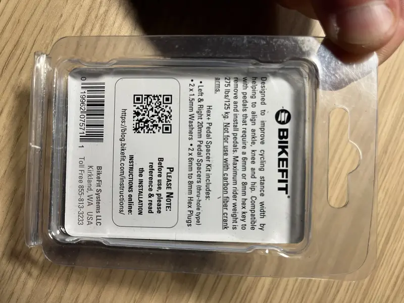

Does anyone know where I can get a top quality pedal extender?
I have problem with pain in my right knee after a long ride.
Basically solved in 2019 after purchase of the ‘Bikefit Hex+ Pedal Extender Kit’ from I-ride.co.uk.
However I find myself needing perhaps another two for other bikes and I-ride have advised they are now discontinued from their supplier in the US (Company BikeFit Systems LLC was bought out and the new owners no longer manufacture and sell them, apparently). I am unsure of the quality of the cheap Chinese ones on eBay as I fear that they may snap under load when out of the saddle, for example. The Bikefit one (sold in pairs L and R) is fantastic quality and wasn’t cheap.
Anyone any advice that could help?
Many thanks.

Not being lazy but was hoping my enquiry would turn up a simple proprietary extender for Allen-key fitting (Keo2) pedals that would fit straight out of the box … like these excellent BikeFit ones. Would rather have a few fitted to my bikes than swop one set of pedals over between bikes. The bike fit extender has a small Allen key reducer that drops in if I remember correctly and the whole extender is now seized on to the pedal (even though well copper slipped during installation) and can’t be removed to fit to another (new/different) pedal. They work really well though: I would recommend them - solved my knee issue. Now … if they only re-started production…
