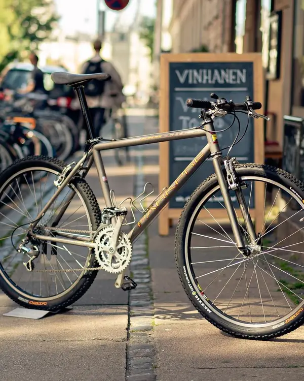

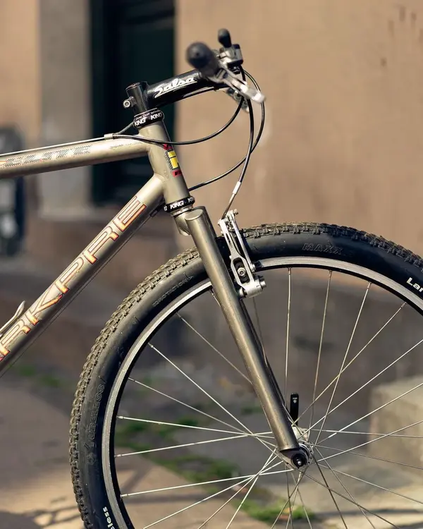

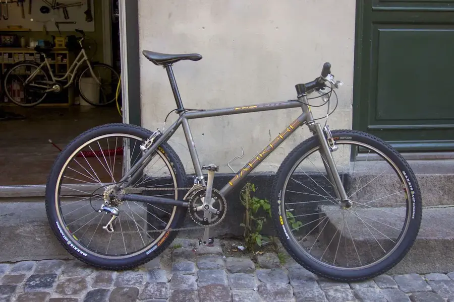

realized all the links were dead, here is so recent pictures
Great looking bike, stinus! Thanks for reposting pics. I read the whole thread and was disappointed every time I couldn’t see the pics, hahaha! I’ve always wanted a ti mtb. Like a Parkpre or diamondback. I have a 1994 (I think) Team 925, 17 inch frame with most of the original parts, including the Tange sus forks. It’s in my queue for attention. Keep it up, and thanks for sharing!

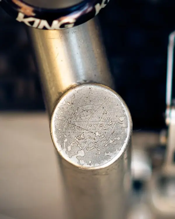

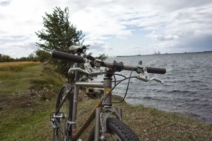

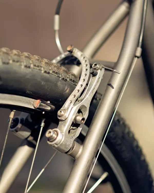

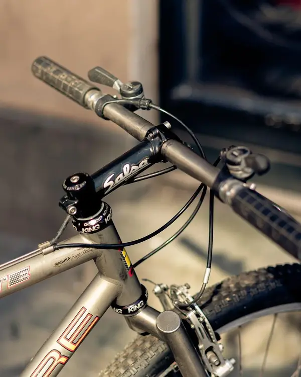

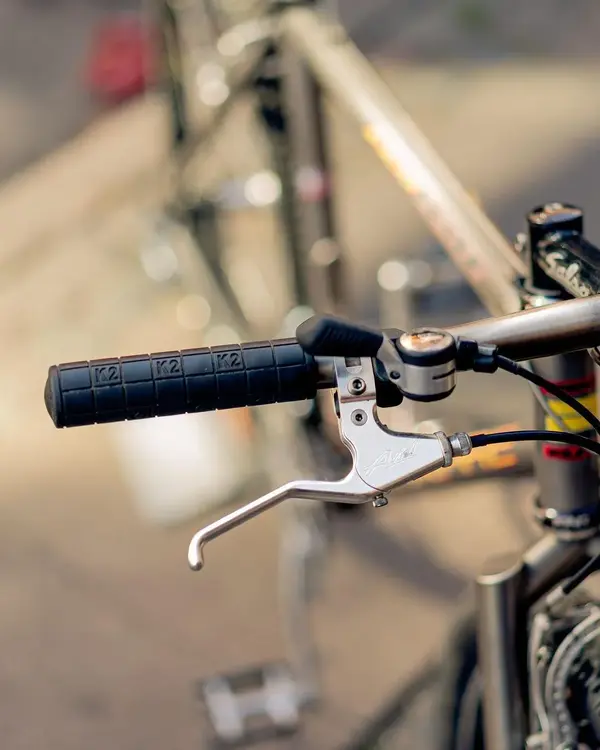

New photos:)

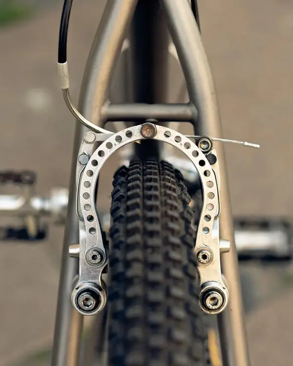

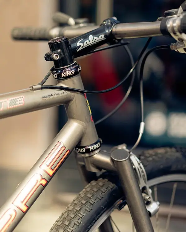

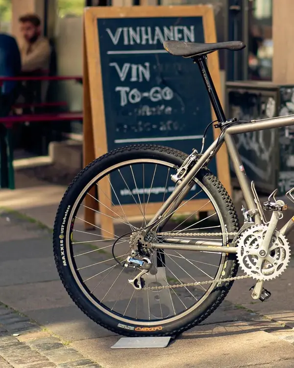

And more:
Fantastic you still have this beauty 8) Can you post a detailed ride report please ? :D How does the frame handle the twisty stuff, is the BB stiff when climbing or does the rear wheel break traction when the frame flexes under pedal load ? Is it stable descending at speed ? How does the Ti fork track with this frame when you ride ? Is the fork comfortable to ride or too flexy and is the braking solid or juddery with these powerful Avid Supreme brakes ? Lots of questions hope you don't mind.
Not seen this thread before and wish there were more like it these days. In many ways Ti frames just look better without all the ano :D
