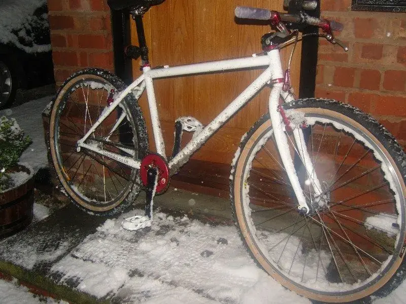

I'll wait until i can afford to repair it before i contact anyone. Meanwhile, i'm still using it. The proof, covered it snow and manky road slush.
