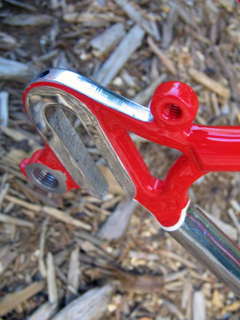

I'm a little surprised by that as my road frame has 1/2 chromed rear end with paint overlapping on it, and weren't the original stumpjumpers chromed then painted?. I's probably not the best surface to paint on to but I can't believe that nothing will stick to it. A decent frame builder/restorer should help you - try Bob Jacksons
Nice example of paint over chrome:
Similar to my bike where the chrome extends way past the start of the paint (only found out the chrome extended all the way after a heavt chainsuck incident. A number of frame builders in the 70s used chrome under paint to give extra sparkle and shine.
EDIT to above: I am not saying here that a framebuilder/sprayer won't want to get all the chrome off first, but chrome can be painted on and has been done for many many years on bicycles
