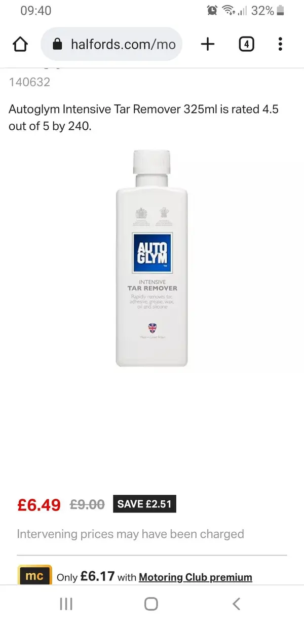

This stuff with a microfibre cloth is great for removing any sort of adhesive stickers without damaging painting etc, use it all the time in my job for removing stickers from vehicle wraps/windshields, painted panels etc Screenshot_20220829-094020_Chrome.webp
