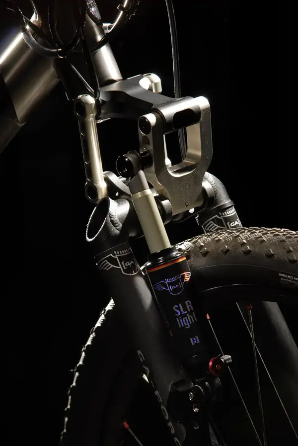

Trick looking bike and the photographer lit it pretty well for the pics. How do you like the way the Kilo fork rides? I found about German A after checking out the Interbike site and I was amazed how they could make a suspension fork, especially with the extra linkage material, so lightweight. I don't think they have any distribution in the US but they sell off their website. Expensive for sure.
the kilo no1 is an amazing fork. besides the fact that it weights only 1120gr the way you see it in the picture , the feel is completely special. i was between the r7 or the sid before i tested this one and although it is very expensive y decision was taken! it feels very different in the corners because it is very very stiff.
the shock absorption is very nice. on the slr light you only have rebound adjustment but you can interchange the shocks. the other ones are a little bit heavier but they come with lockout and other options.
so in 3 words, it's stiff, plush and lightweight

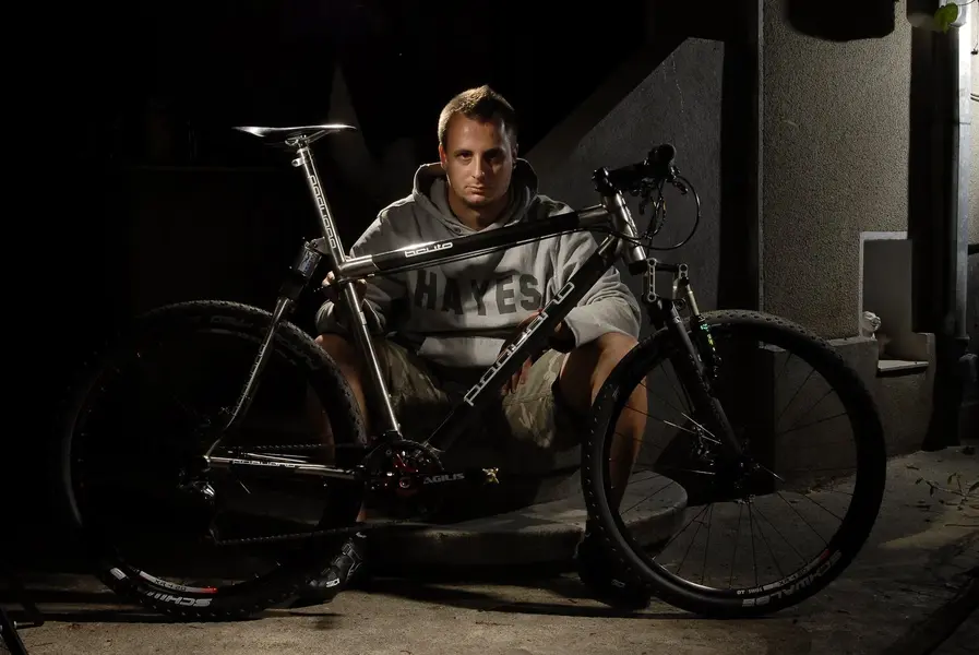

i wanted to look friendly and to smile , but the photographer told me to look angry, and i don't look, behave nor am angry, therefore the outcome was kind of funny.
i am not in the pursuit of fame, i only did it for the bike. i even told them to only take pictures of the bike, but it appears i am irresistible handsome and they wanted me in the pictures as well :D
