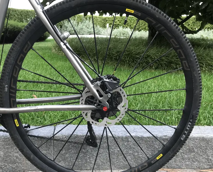

Did the frame come with a rear drop out setup for disk brakes? Reason I ask, I have a '94 Ocoee and would love to add front and rear disk but the frame isn't setup from the factory. :-(
Thanks ahead.
Thanks ahead.
As you can see in my #18 post… I welded it… or better…. I asked to a Titanium bike welder (Rewel) to do it!😁
You could see the adapter welded to the frame in the picture. And he did a great job IMHO.
