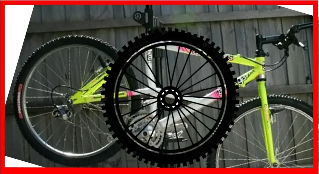

Bottom line: the abrasive end of the axle of the loose front wheel will scrape against the e-stay frame for the entire time in transit.
The result: a couple of square inches of paint (and even a bit of metal) gouged away from an otherwise pristine bike.
I generated the attached pics (OK, so I won't win any image manipulation awards 😟 ). Imagine the red boxes are the shipping boxes. In one box goes a conventionally-designed 2-triangle MTB, while in the other box goes an e-stay MTB. Imagine further that the front wheel was removed and packed alongside the frame, while the skewer went into a separate baggie. - a typical packing job. The danger now is that the 1/4-inch hollow steel tube (the front axle) is exposed and ready to scrape against anything it touches for the entire duration of its "safe" trip to its caring new owner.
When viewing the pics. note that the vicious, abrasive end of the axle of the loose front wheel comes nowhere near the conventional 2-triangle frame, whereas in the case of the e-stay, that ruthless, savage, sharp-toothed end of the loose front wheel's axle is poised and ready to hungrily chomp down on the very part of the bike that makes it unique: the elevated chainstay.

OK, back to the task at hand: Before that front wheel goes into the box, a couple of those 5-inch black plastic discs (I'm not sure of their proper name, but I'm sure there was much cursing involved when inventing them) should be installed on BOTH ends of the bare axle, and even taped to one another multiple times thru the spokes using some tape with significant strength and durability. THEN, a piece of cardboard (preferably of significant thickness and perhaps a couple of square feet in area) should be inserted between the loose front wheel and the frame so that the black plastic disc slides/rubs easily against the cardboard, not the frame.
Without the black plastic discs, it's just the ends of the metal axles rubbing against cardboard, and the cardboard won't last long against a piece of 1/4-inch metal tubing rubbing back and forth against it for hours). Removing the axles completely would also help, and in that case you probably wouldn't need the black plastic discs, but I'd still err on the side of caution and recommend placing a good-sized piece of cardboard between the wheel and the frame so they don't rub against one another.
