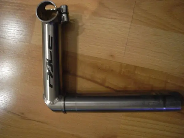

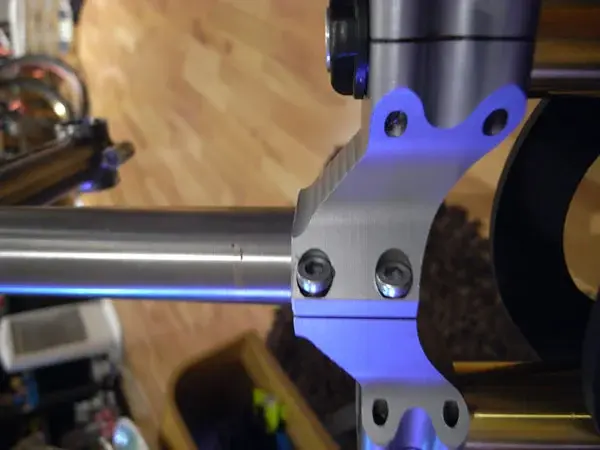

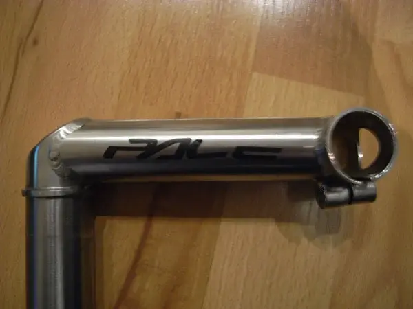

here you go - hope these help. like pete said, you're basically just running the headset upside down:

what does it look like from the top please
