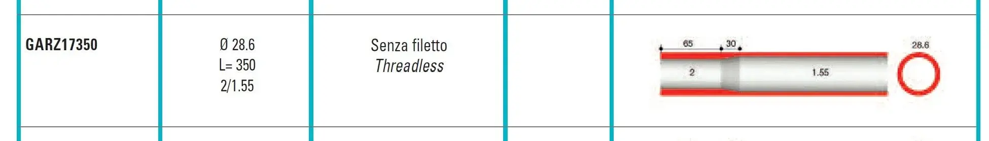

Classic steel 1-1/8" ahead is single butted 2/1.55mm. There were some 2/1.2 steerers around, but only really designed for road use.
Pace certainly just used off the shelf steerers (Presumably Reynolds) for their RC30/RC35 forks at least, just with the circlip groove cut into the lower end.
