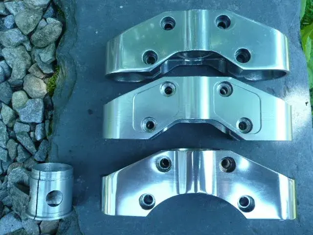

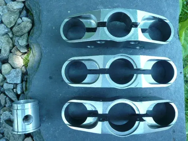

With no reducer shim (shown below) you will need a new crown to go bigger than 1 ".
The larger crowns have a slight bulge where the fatter steerer goes in. You will also need a Race Collar of the correct size (speak to Tim/Justbackdated)

Lots of shiny things there, could just get a 1in threadless steerer for fitting to the new bike, but not sure I even want them on it to be honest
They look like they would shake my fillings and remaining teeth out :D :(
Might just flog them as they are and hope they go to someone who wants them (for a Pace I presume?)
Sure I can find something to spend the money on, ah yes want a new seatpost,stem, bars etc etc :D

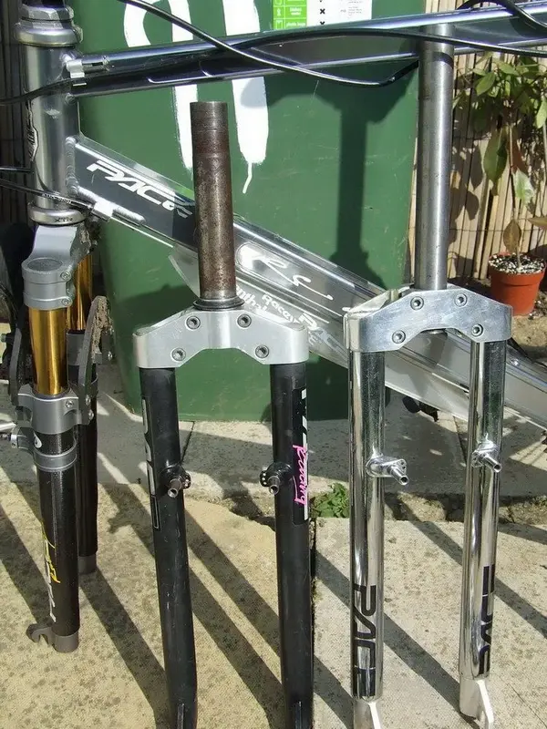

Steerer's for these are VERY common and should cost around £12
I might still have this 1" steerer kicking around (on the chrome forks) >>

Thanks for the info Neill and the steerer offer.
Might be a bit mercenary, but now I have found out their worth think I will sell them and put the cash towards a few other parts that I want for the Merlin. For a start it has a shimmed seatpost and not keen on them at all, so the money would be very handy
