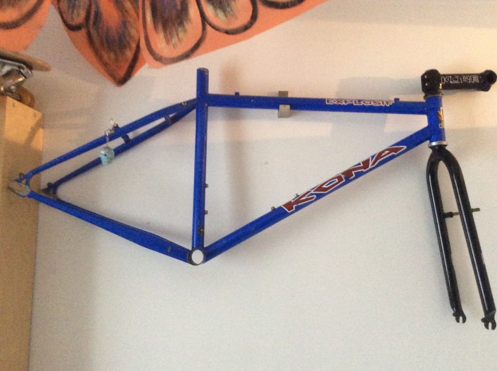

flash Retrobike Rider Feb 11, 2017 #1 Would I notice much difference if I fitted a 26" wheel and matching frame to the longer 440mm A to C forks? Or should I go up in the attic and remove the Pace forks with 420 A to C from the Inbred?
KermitGKona88 Gold Trader Overbury's Fan Feedback View Feb 11, 2017 #4 Re: Depends on the year of the Explosif post 97 should be okay pre 97 I would fit the shorter forks
Thias Klein Fan Feb 11, 2017 #6 What length is the P2? If its 400, I would strongly advise against the 440. You will end up with a bike that only wants to go straight...
flash Retrobike Rider Feb 11, 2017 #7 P2's are a tad over 400. It seems a trip to the attic may be called for...
