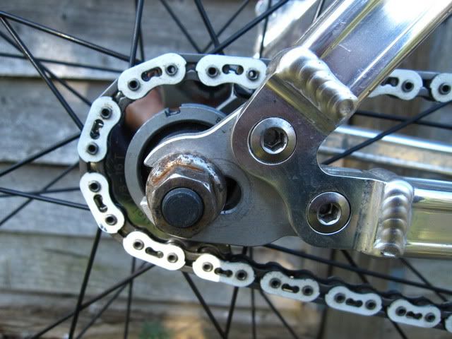

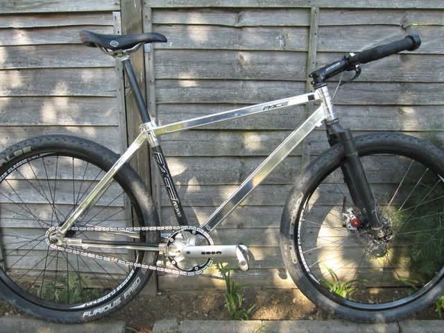

Here's one to make the purists cry: my RC300 (F30016277), stripped down as a fixie :shock:
Horizontal dropouts,
I cut the RC31s down by 40mm and re-bonded to get the geometry right.

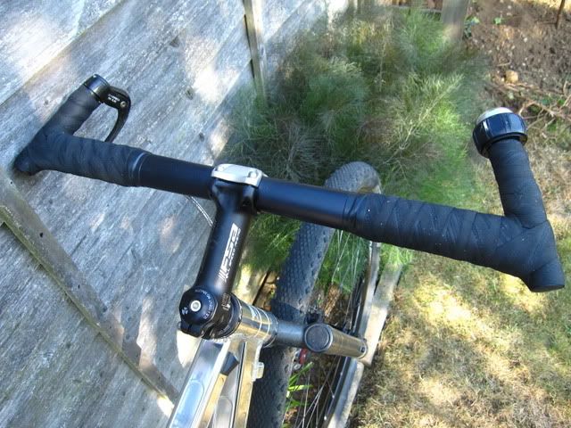

Homemade aluminium oval section bars with welded in bar ends, TT bike brake lever, Nokon cable and a bell:
Coda M900 road cranks with 'Badger' chain:

I thought it looks a little squat, the 40mm off the forks explains it.
I agree, but I wanted to run it as a more roadie position 72 degree parallel frame, that 40mm would swing the angles back to 67-68 degrees. Just shows the frame's versatility...
This is vandalism.
You're probably right, but I haven't cut or drilled anything and I do have all the other little parts lovingly stored.
I used to ride it with gears, but just couldn't take the rear brake hose rattling inside the Top Tube on every bump.
I'll put it back as a full (as possible) UK off-road build soon :D I just thought I might upset a few people first...:wink:
I assume they were originally 440mm -> 400mm (did this myself for an Orange Vit T2) and not 420mm -> 380mm :shock:
