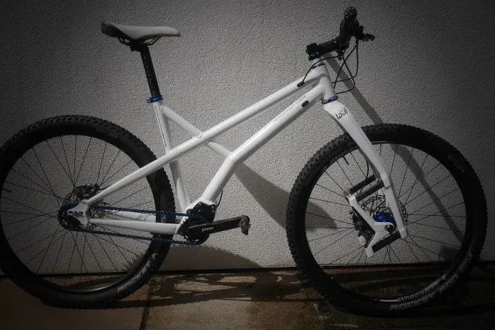

Re: No, it's a gearbox NOT a bloody motor...
Now with 50% added weirdness :D
Lauf fork...I'm always partial to a linkage fork...even when there are no actual pivots involved...
All the best,
I tried the Lauf for a week ....... conclusion.... not for my posture and riding style. The Pinion is there to stay though!
I tried a Lauf fork in Aviemore couple of years back.... I wasn't sold.
On fire-roads I thought they were great, zero trail buzz.... was spooky how well they worked, but with no pivot or stiction that's where they excel.
Throw something more technical at them though and it all starts to go wrong. Tree roots and small rocky sections caused them to lose the plot, I kept stopping as it felt like something was broken, like the steerer tube had an elastomer, the fork just couldn't keep up with bar inputs....
Funky looking though 8)
