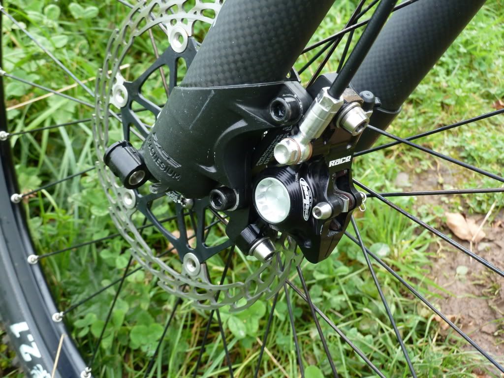

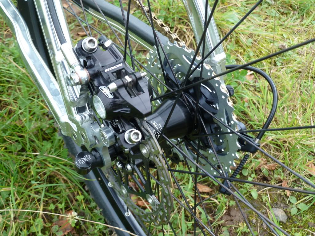

New brakes and 10sp drivetrain fitted and I think this might be finished now :D -

Brakes: Hope Race X2 with Matchmaker clamps
Brake Discs: Hope floating 160mm

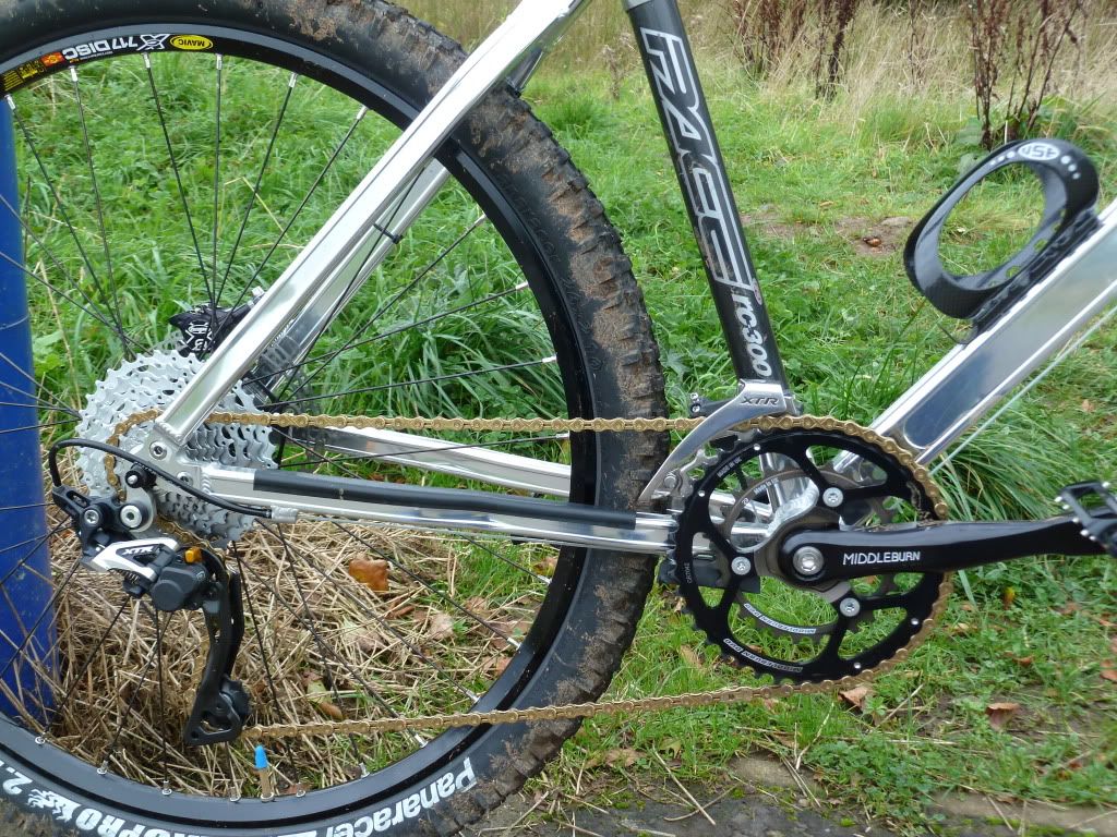

Shifters: Shimano XTR M980 10sp
Front Derailleur: Shimano XTR M970
Rear Derailleur: Shimano XTR M985
Derailleur Cables: Gore Ride On sealed
Cassette: Shimano XT 11-36
Chain: KMC X10 Ti Nitride coated
Crank: Middleburn Duo ISIS
Rings: Middleburn Slickshift / Hardcoat

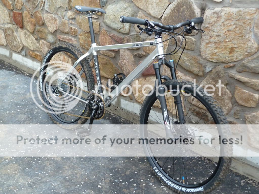

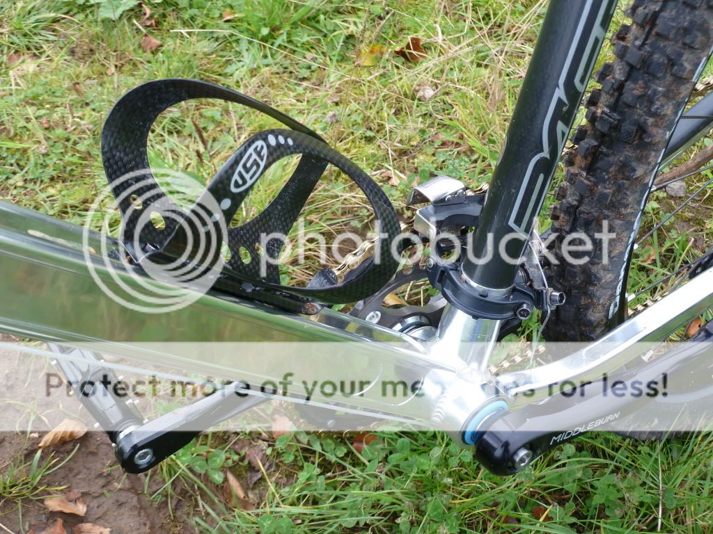

Its not exactly 'period correct' so I'm not expecting everybody to like it, but it's such a great frame and still contemporary in my eyes so I think the latest kit works well on it.
I'm very impressed with the 10 speed. The shifting is noticeably smoother than M970 XTR and a bit quieter too. I need to change the front mech though as it won't come down far enough causing the chain to come off occasionally when shifting up. The coming winter will tell how reliable it all is and how it copes with mud and gloop.....

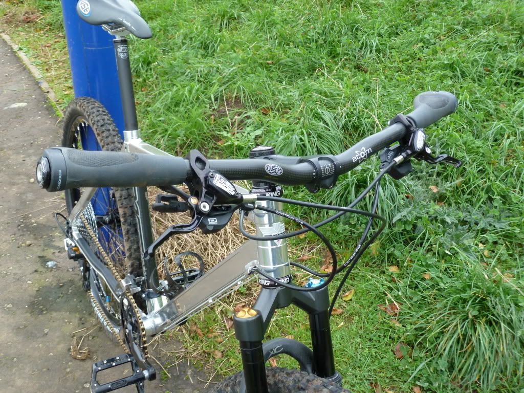

And some more pics -
Looking spot on now. Good choices all round. Just need some clipless pedals and it'll be a proper XC bike.
It's a good representation of how I would have done a modern build on mine - but I think that as you are following the laws of Pace and doing the Hope/Middleburn thing, that you need a pair of RS8-X cranks running on a Pace or Hope external bearing BB as the icing on the cake.
Am running M953 front mech on mine with 42-30/11-32 if that's of any use in terms of advice.
Looks great! Like all the little touches as well. I bet it's fast! How are you finding the ten spd? Is it worth it? I'm toying with it myself for the Cotic.

The 10 speed is just that little bit slicker than the previous XTR, probably due to the cogs being closer together so I'm very happy with it. I'm running 42/29 on the front and I now have the same spread of ratio's as I had when it was 3x9. Is it worth it? I'd say if you can afford it then go for it but its a big investment for one extra cog at the back.....

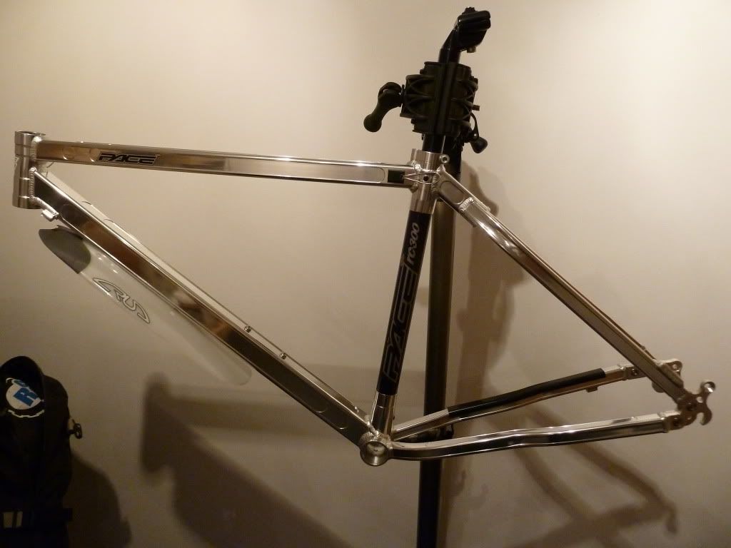

So as some of you may have noticed, I put this frame up for sale a few weeks ago. I thought it was a keeper but sometimes you have to let go :cry:

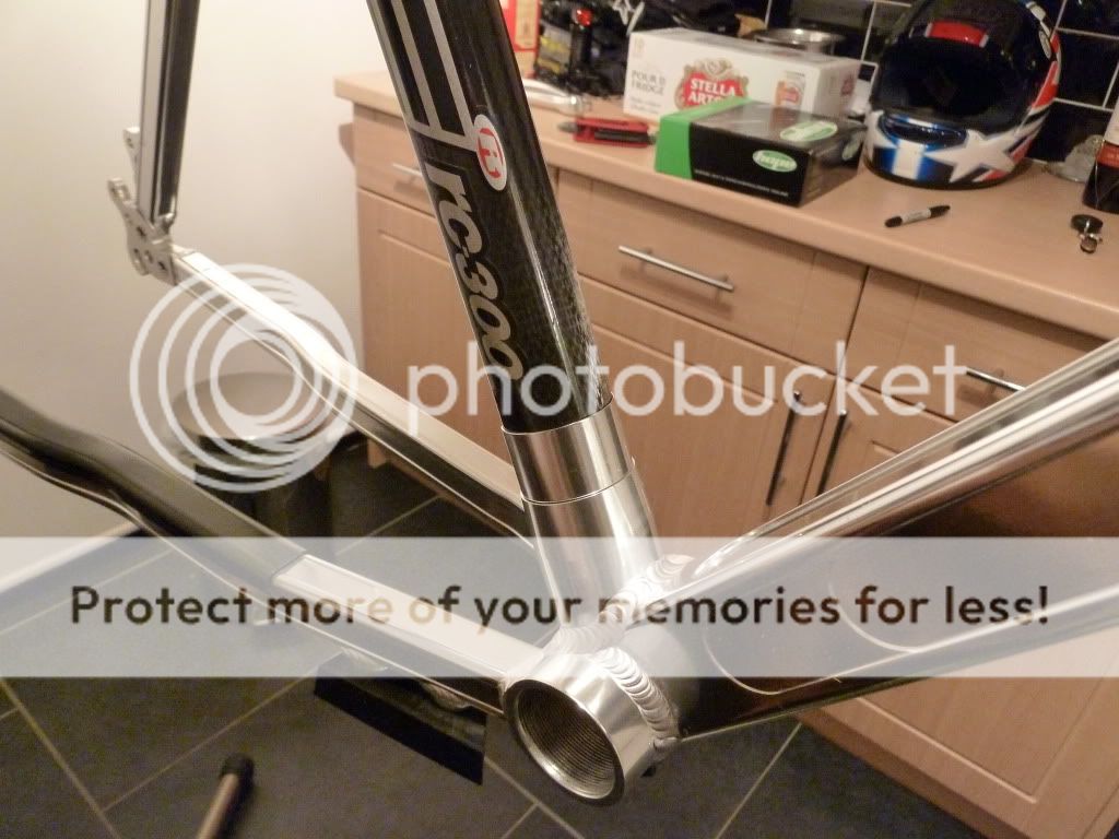

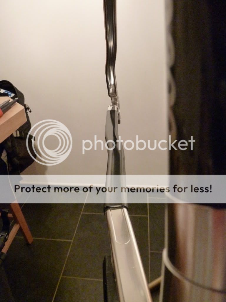

And today my replacement arrived - another 16.5" RC300 in silver, except this one is NOS :D
It cost me a bit more than I would have liked once the postage etc was taken into account but I think its worth it. It's brand new and never built and even came with the crud guard and carbon armour patches it was originally supplied with 8)
Don't expect the build to change much but here's some pics of the new shinyness -
