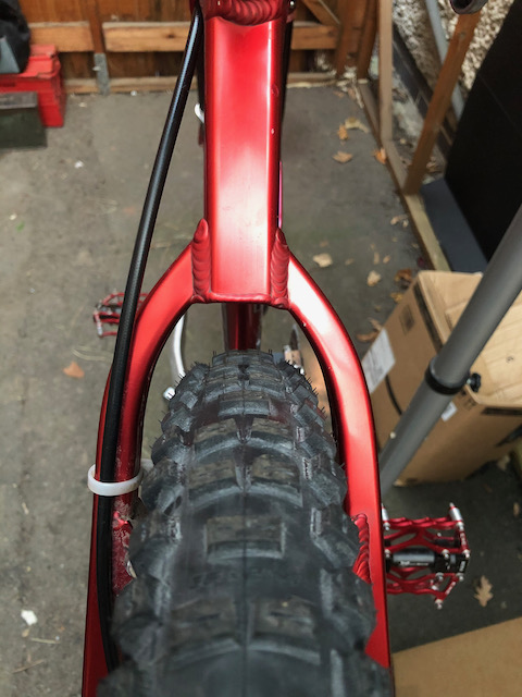

I've been riding a lot over the summer, partly as physio for a broken leg I sustained in January, and now the weather has turned I've been sliding about a fair bit on the trails around here. I bought some knobbly tyres to help with the mud (Schwalbe Magic Mary 26"x2.35" at the front and a Big Betty 26"x2.40" for the back) and, after struggling to get the tyres on the rims, was disappointed to find that the rear tyre is clashing with the front derailleur cable and the anti-chainsuck plate at one point around it's rotation. The wheel isn't spinning perfectly straight, and while it's only deviating by a millimetre or two, it's revealed something I fear may be more serious.
The wheel was mounted in the dropouts with the bike on the floor, so I'm certain it's all the way in, but looking at it from the rear the tyre is quite obviously to the right of the seat post. Looking more closely at the point where the tyre clashes with the cable and anti-chainsuck, I can see zero clearance on the drive side, but about 1cm on the opposite side.
The Big Betty is obviously a tight fit, and while I could fix this with a slimmer tyre, I'm now somewhat concerned that there's something wrong with the wheel or frame geometry. Is the RC200 meant to have offset chainstays and I just can't run tyres this wide, or does the wheel just need re-dishing to recenter it?

Here's some pics, hopefully make it a bit clearer:
Looking down from the rear, note the tyre is offset to the right (it looks worse in real life!)
View towards bottom bracket from inside wheel radius, note tyre clashing with anti-chainsuck plate
Looking down from underneath saddle, note space between tyre and chainstay on non-drive side
Similar view, opposite side. Note lack of clearance between tyre and anti-chainsuck plate
Could be either the wheel or the frame. Fingers crossed the former. Easiest way to check is to flip the wheel in the dropouts and see if the misalignment also swaps sides.

Cheers, already found that suggestion elsewhere, but the cassette clashes with the brake calliper when I tried that (disc brakes btw), so couldn't get it all the way in to the dropouts. I guess I could try removing the brake calliper and trying again tomorrow when I've got some light back
Wheel just needs re-dishing as per the manual.
Take it to old school LBS with the manual and get them to sort it. Wont take them 10 mins.

Aye, the wheel just needs 'un-dishing' a little to centre the rim in the chain and seat stays, nothing wrong with the frame.
Tyre is probably a bit on the big side, Pace frames were built for XC racing and Max tyre width in fashion of the day was prob a 1.9" :wink:
