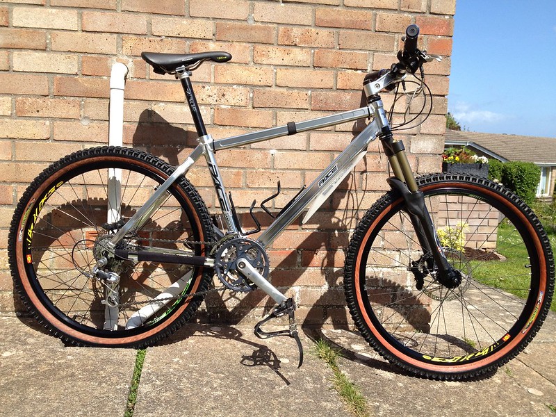

Well I picked up the RC39 forks from Bowsho on here last monday for my RC300 build but I couldn't wait for the 300 to be finished before I was able to use them so I've chucked them on the 200 for now and I love 'em so much they are staying on the 200 and I'm on the look out for another set for the 300 :D
Also, I finally got to use the Hope Head Doctor that came with the headset as it fits inside the steerer on the RC39's but not the RC36's and I've got to say I'm really impressed with it. I had heard bad things about them coming lose all the time but I went to Glyncorrwg on Saturday and didn't have one problem with it over the 20 odd miles we did, so much easier to fit than a star nut too.

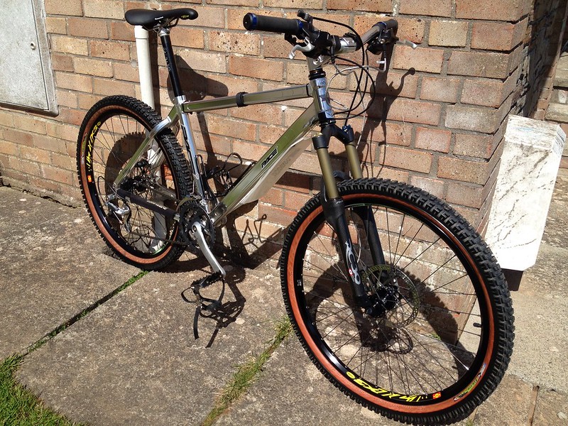

Wow, just seen this one, great thread, and even better that it was successfully repaired!!
Reminds me of my damaged frame, repaired three years ago and still going strong :)

wow - that cam out surprsingly well:
did you grind that all by hand? :o could you have fitted a jubilee clip to act as a guide to get the edge perfectly striaght?

Cheers ;) yours is the one that was painted pink right?
I used an angle grinder with a solid grinding wheel to shape but couldn't fit a jubilee clip to use as a guide as the top tube is in the way. Yeah it's not perfectly straight but it'll do for me ;)
Wow mate, that turned out a treat. I've also had my bike repaired at a motorcycle shop in similar fashion with 2 plates going over the cracked section. In my case it was where the rear shock attaches to the frame. That was 14 years ago and still going strong so I'm tentatively calling it a job well done! I however haven't got it all pretty looking because I like the industrial look it gives the bike..............or I'm a lazy bastard.
Hi ,I have spent thousands of hours dressing welds,at work,and realise just how difficult it is to get it right using a grinder freehand.That is bloody fantastic!.I admire your determination and attention to detail,not easy to get it right.I love the bike and can appreciate how gutted you must have felt ,after owning it for so long to discover the crack,I can also be like a dog with a bone at times,my non bike mates tell me "It's just a bike",,But we know better...Top marks dude!
Mark.
fun at fiftyish":ocbuhmr4 said:
Hi ,I have spent thousands of hours dressing welds,at work,and realise just how difficult it is to get it right using a grinder freehand.That is bloody fantastic!.I admire your determination and attention to detail,not easy to get it right.I love the bike and can appreciate how gutted you must have felt ,after owning for so long to discover the crack,I can also be like a dog with a bone at times,my non bike mates tell me "It's just a bike",,But we know better...Top marks dude!
Mark.
Thanks for the kind words ;) That first moment when I picked up the angle grinder and turned to my mate and said 'Right, I'm going in' was a heart in mouth moment I can tell you, but slowly-slowly-catchy-monkey proved to be the best plan of attack, probably took me about 4 hours all in all and many tea breaks to build up courage after each grinding session :)
