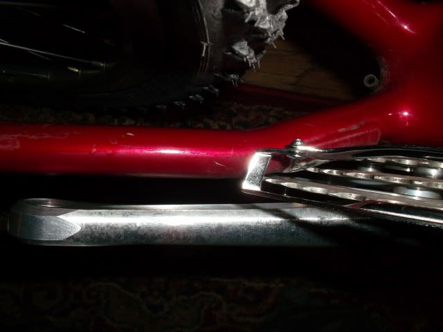

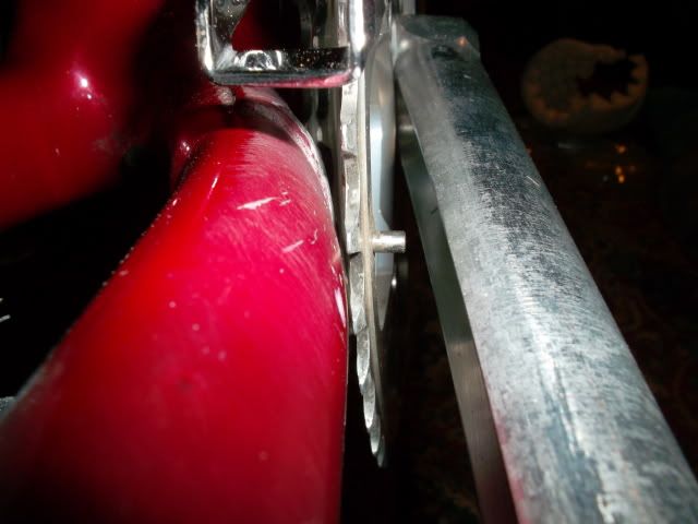

122.5 (hope ti) was WAAAY too short for both my RS1 and RS2 cranks. I had to get a 130, but a 128 probably would have worked too.
That wasn't on a Pace, but was what I needed for the right chainline.
^^^ that's with the 122.5. Literally nothing between the rings and the chainstay, I think the 130mm only just gave me a 47-48mm chainline, I can check if you want?

I thought they used a 118 to 122.5 bottom bracket. That picture above looks like it's rings are too big for the frame given how far the arms are away and it should have CD cranks on it.
Pace only specs 1mm minimum of chainring clearance, as was the norm back then.
