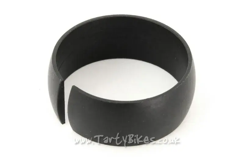

Didn't realise I need some sort of shim/washer to go around the cylinder in order for them to fit the mounts!
Is this what I need?
https://www.tartybikes.co.uk/hydro_rim_ ... E7fQ%3D%3D

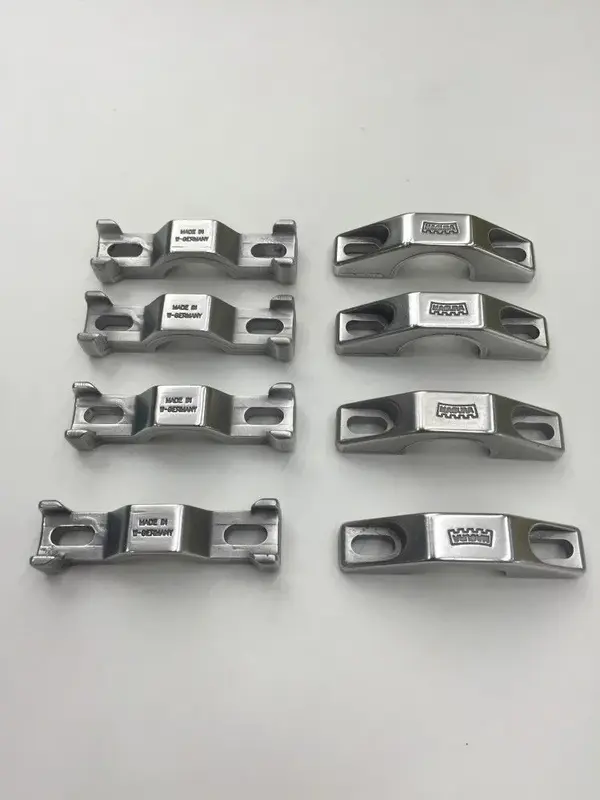

Are the Maguras you're using HS33's then?
- I'm no Magura expert but the mounts used for the original Hydrastops on my RC100 look like this. Marked made in W.Germany too!!
I remember someone gave me excellent advice on the fluid hose too (I can't remember who :oops: :oops: :oops: ) that the modern one will fit the old Hydrastop ones.
There's plenty of Magura experts here.. I'm sure one will be along in a bit!

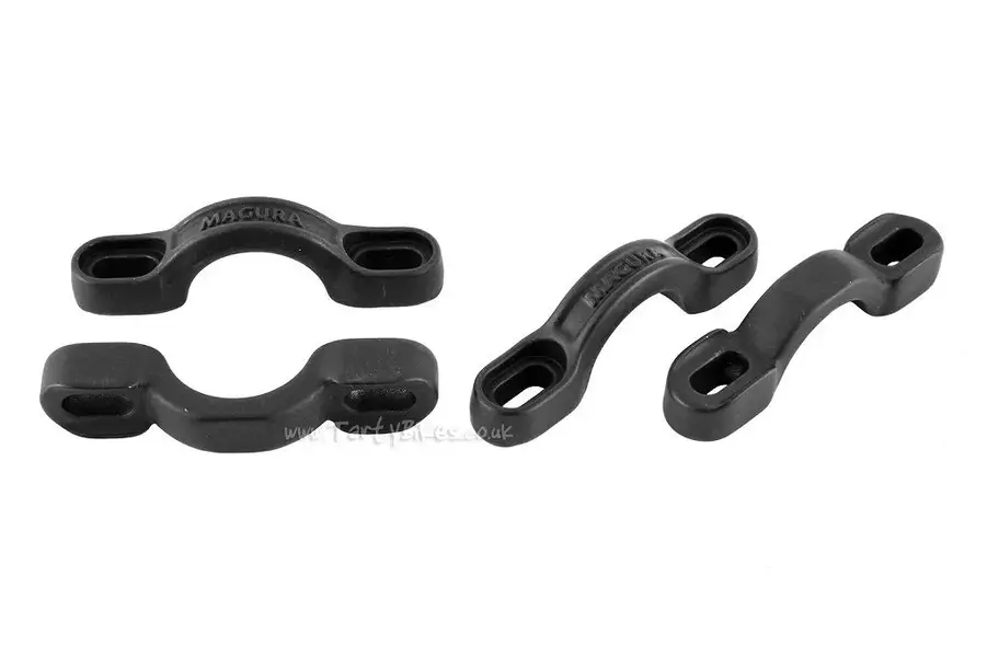

Looks like I'm using the wrong mounts then...after all that!
It's these, which seem to be the only Magura offering out there. magura4boltblack2.webp

It seems these washers allow the modern mounts to fit just fine with the Hydrostops, so no need to track down original mounts :)
A new length of hose has arrived too - technically I now have all I the parts needed to get it rideable! Just need some time... large_magurawasher.webp

Latest on the Pace is that I have set-up the front Magura, and in doing so have discovered that Maguras on direct mounts appear to be the most impractical things ever. For instance in order to get a wheel out you have to disassemble one side of the brakes, then set them up again after you've put the wheel back in? Or am I missing something? Letting the tyre down completely might work, haven't tried that yet. Getting a puncture on the move would be whole load more annoying now! :facepalm:

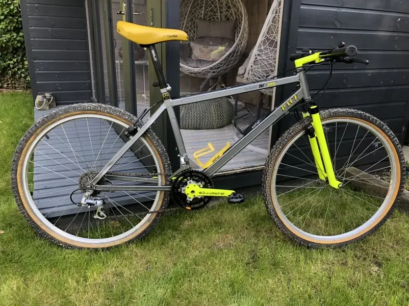

This is now fully assembled and ‘rideable’ :) I say ‘rideable’ as In building it up I’ve discovered that the rear wheel has a substantial buckle, so getting the rear brake anywhere near correct isn’t really possible. Guess I’ll be buying a truing stand and teaching myself to true wheels during the lockdown :roll: 4BF60E75-CF48-46ED-8853-2B93181D80DE.webp
Blimey, that looks great. Well done once again for rescuing it.
A couple of YouTube videos and a cheap truing stand should see you right. Reminds me that I need to sort out a set myself, which weren't tensioned properly by the LBS :roll:

Seat stay bridge solution...
Looking good! 8)
If you didn't know that an RC100 had no mountings for mud guards/reflectors - the bolt repair on the seat stay bridge looks almost stock. Good choice on colour, looks like an original renthal one like the original bottle cage mounts.
The only change I'd make is to either have 2 black or 2 yellow zefal bottle cages, rather than 1 of each. That's just me though, everything else looks spot -on.
Don't be daunted by wheel trueing/building. I bought a wheel jig, decent spoke key and dishing tool myself and so far have built myself 4 pairs of wheels. Plenty of on-line guides available. Give it a go!
Great job! 8)
