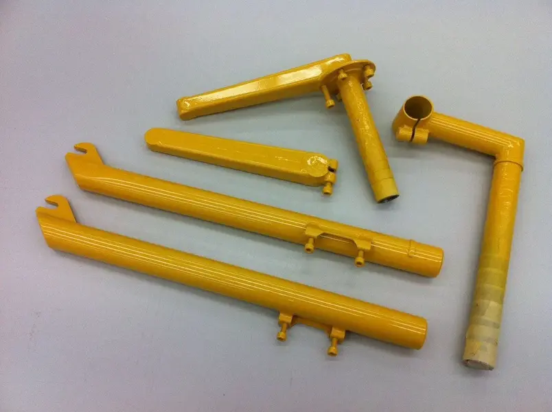

Stem and cranks Fresh out of the tumbling machine and ready go to paint
pmKu9FMdj
Anyone know the paint code for the early pace 100 stems and cranks
It does not look luminous yellow like the later rc100

Thanks for the pictures boy o boy
They are a big help
I might get the parts powder coated as I can get this done very cheap via work
So I think the nearest to yours and the original is ral 1003
pnp7bzBJp
Update after going to the powder coaters its I think ral 1018 is closer in real life
We will find out next week :D
