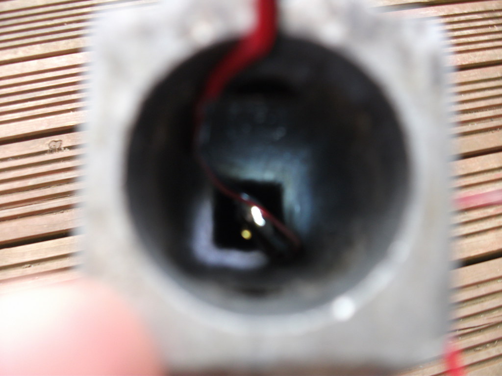

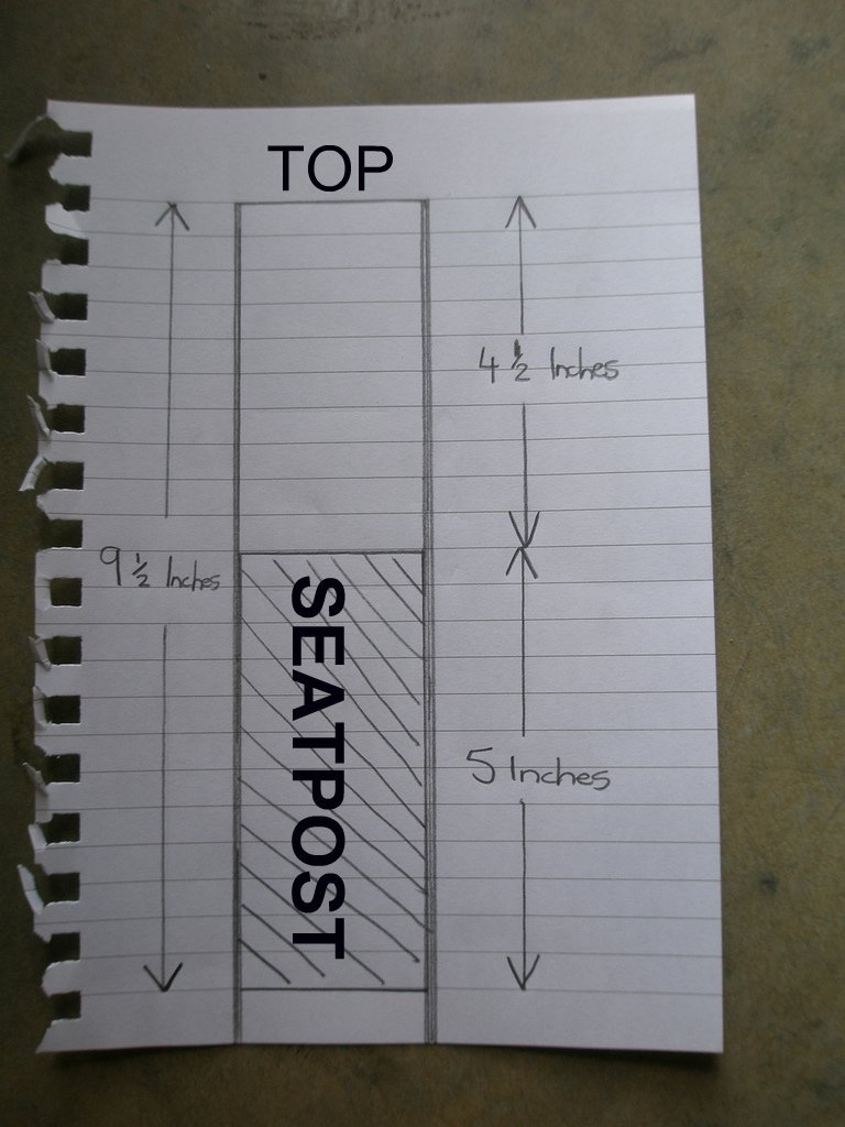

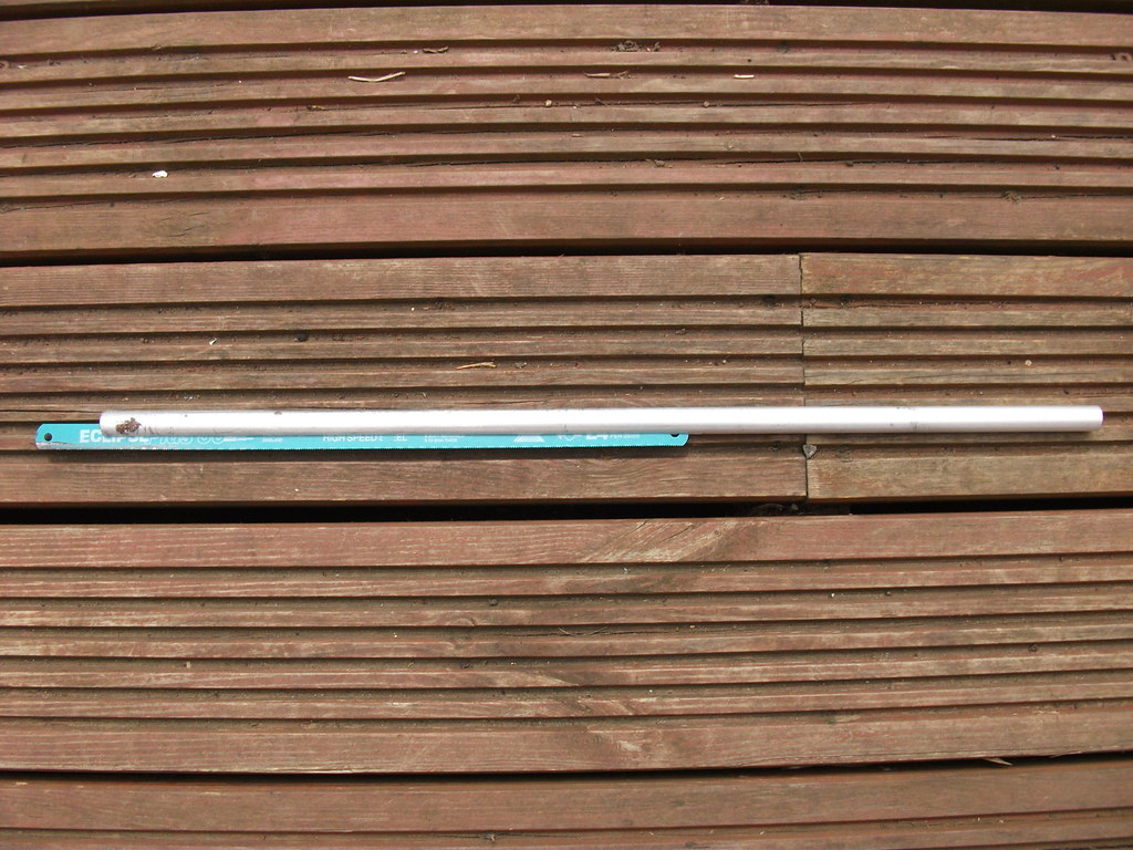

I managed it on my F1. As long as you cut the top of the seatpost off. Below are the problem, the tool, and the aftermath.
You my get lucky and it may come out with plusgas, you may be able to carefully saw through it with the above method. You may find that it just won't give. I have experiences a number and have only been beaten by one. I have suffered blood sweat and tears on others and would be very woried about damaging the frame on this one but if you take it easy you could come out on top. If you rush it there's a good chance you'll damage the frame and or yourself.
