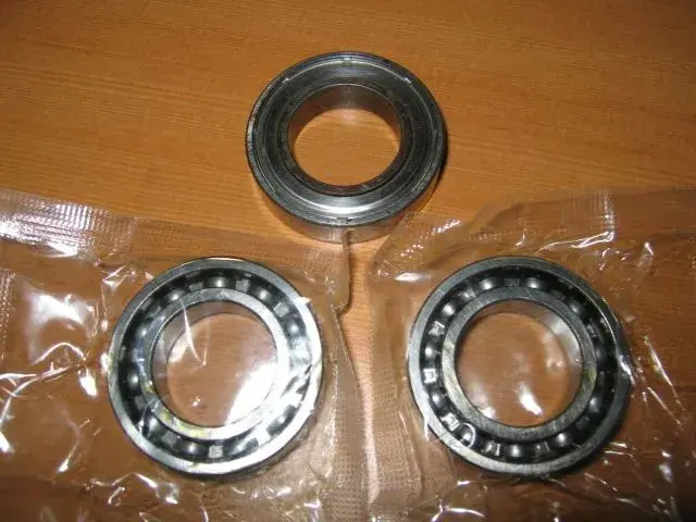

These are the ones you are after...
One issue is these don't have a shield on either side of the bearing, the originals were shielded on one side and open on the other so the grease could be pumped in through the grease nipple on the BB
I have three of these, one has a shield and was used breifly the other two are brand new, unopened
Coding is SKF France ~ 619/22
I bought them as spares when I had my RC100, Pace had run out and that must have been 10+ years ago :?
They might be for sale :wink:

Got my bike back now and got the bearings out.. Mine are marked slightly differently to those above.
"Japan 69/22Z"
