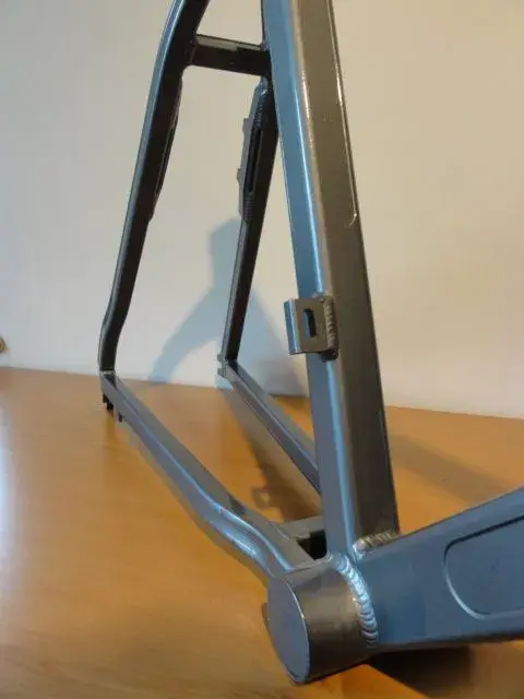

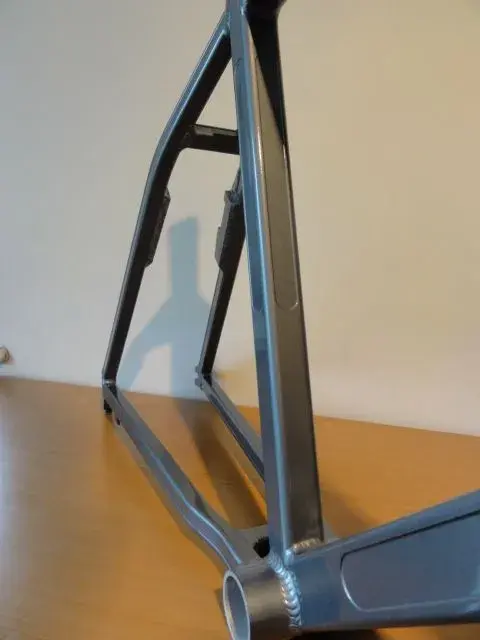

The very early RC100 frames, as you rightly say Fluffy came without any front mech mount and had a band fitting wrapped around the square seat tube, however I have only even seen 2 of these and from frame number 120'ish they came with a braze on mount up until the square tube was replaced with a round tube in the F2'ish era
Here's RC0108 with no Braze on mount and also a straight drive side Seat stay, the later models came with a Braze on mount and bent Seat stay ~ RC0360

My frame is a late one from what I can gather - frame number 365. Strange as I'm sure I've spotted on a thread somewhere that RC200 frame numbers started at a lower number, not sure if that means they were building the 100 and 200 concurrently for a while?
