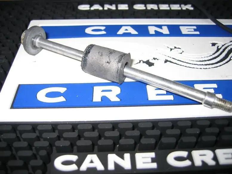

two big uns in the carbon lowers
two smaller ones are top out elastomers and go up into the hollow dropouts from below! FORK REBUILD.... DONE! :D
Depending on age the guide rods will either be attached to the stanchions and the elastomer is held in with a washer and bolt or it will have a rod that go's in from the bottom with a shoulder built into it!
You undo the fork by unscrewing a 4mm allen bolt underneath, this has a circlip and plastic shoulder on it, so I reckon this is where the little elastomer goes??
Im restoring it and there was no elastomer there to start with, but this all makes sense now.
Cheers!
Thats the one, perfect! when my stendec grease gets here it'll be sorted... I think it may be a tad soft tho - pace could only supply medium elastomers, still all will be revealed in a week or so !
