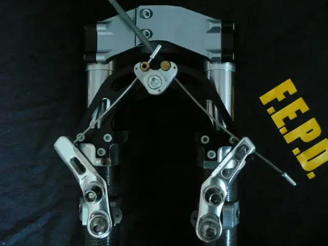

7) More forks - rocker for cantis. I've got a nos kit, but it's nothing like on any other one on my forks - see pic below How does this fit/work?
Fit it as well as you can and we'll tell you how you're doing. It's very hard to explain in writing in a hurry.
OK, so fitting the rocker is simple enough, washer against the fork, rocker, spring (just the one), spring cover then bolt it all together.
The bit I am struggling with is the brass washers for the cabling - it's been a while since I fitted cantis from scratch, with a rocker.

Yep-washer against bridge, then rocker on the brass bush, spring and adjuster plate with bolt fitted so head sits in adjuster plate socket.[you have a spare washer and spring!]
Outer cable stops in the socketed brass barrel sitting in one side of the rocker 'hooks' and the inner cable goes on to the bolted clamp on the canti.[I think usually the rh one]
Then you need a short 'bridge' cable or a short length of cable with a barrel nipple to extend from the other side of the canti set to the bolted brass nipple which sits in the empty 'hook' of the rocker.
Clear as mud!! A picture is worth a 1000 words but I cant find one!! :roll: :wink:
Thanks Tim, that's how I thought it worked, just seemed that the brass bit that attaches to the short cable seemed too small to me, which is what confused me. That picture did speak 1000 words, thanks!
