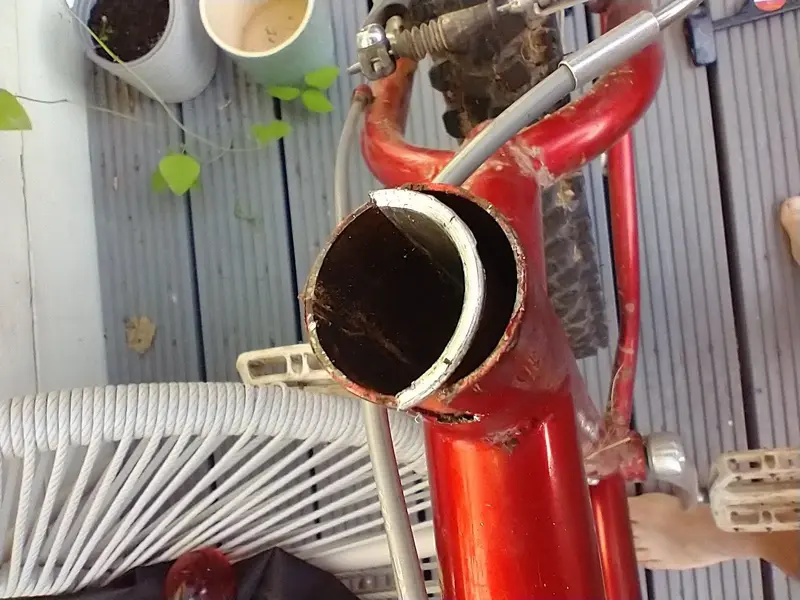

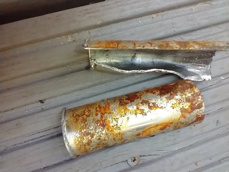

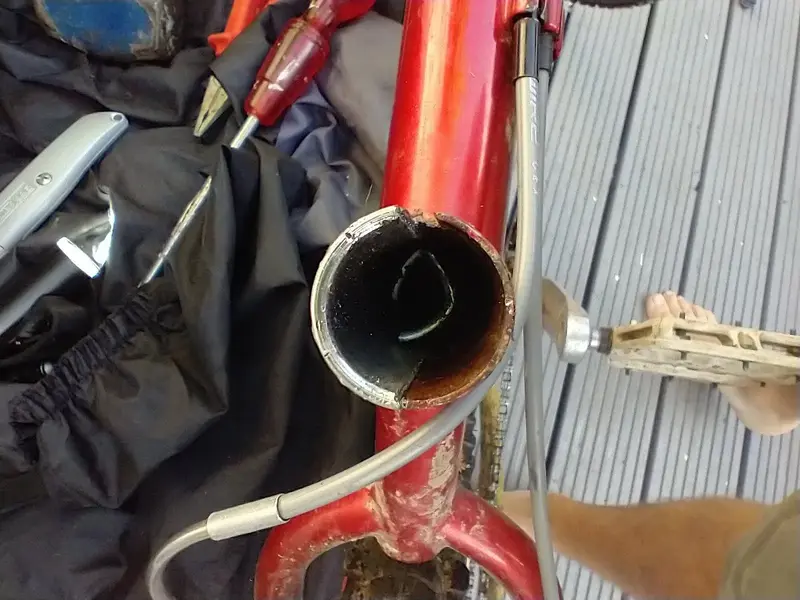

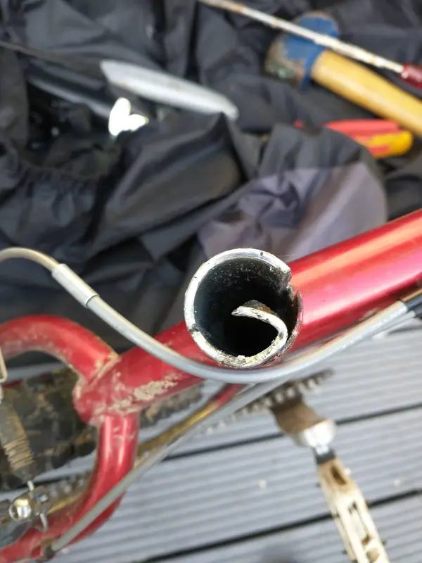

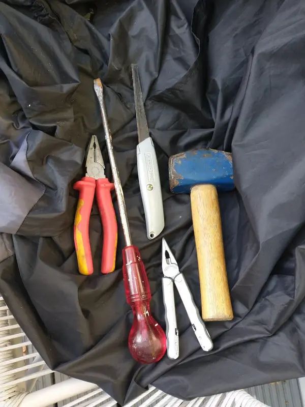

Right, after weeks of plusgas, agonising over caustic, and a call to local machine shop re. pulling, reaming etc., I followed said machine shop's advice and went down hacksaw route... sawed at slit and opposite, took 10-15min at most; hit first slice's lip with large flat screwdriver to pull away from wall, hit vertically down on it to drift away from stubborn corrosion at base, pulled out with narrow pliers, repeated lip bash on second slice, pulled away with narrow pliers again. Doneded. About 30-40min all told.
Owing to hooves rather than opposable thumbs, I put a tiny nick/cut into seat tube on expansion slit side right at top; that's the only collateral damage. Will fill that for peace of mind, wet and dry/wire wool then hopefully plastic shim winging its way from SJS should slot in tidily enough...
