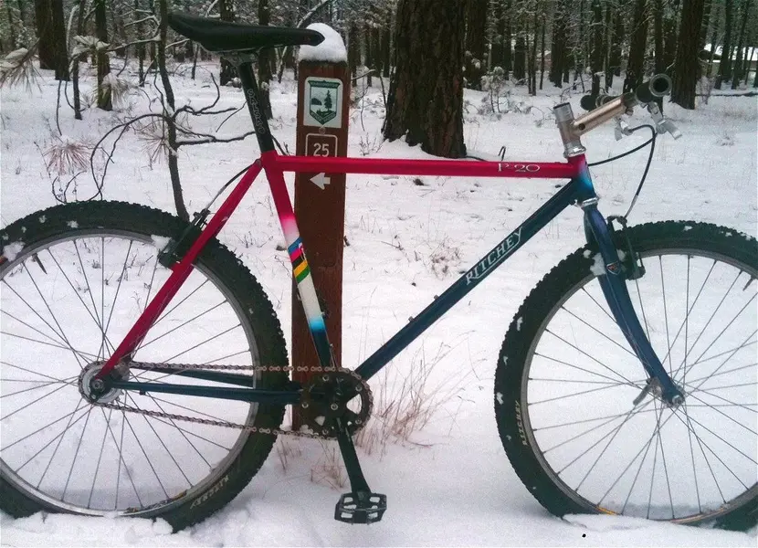

2014 is starting great, managed to score a very nice 95-96 Ritchey P-20 in fine shape. The only catch being I had to drive 7 hours one way to pick it up.
So gathered my riding pals and hit the road. 1000 miles (round trip) and 3 epic rides later I now have the bike in my clutches.....and real ideas of what to do with it.
1st pic is how it was built. WI eno wheels, Paul levers, carbon risers, Thompson stem, beautiful IRD Ti Expedition fork, and 2.3 Mega Bites. Nice build but not entirely thought out.
Current idea is to install a rigid and sus-corrected fork to sort the geometry, put on a geared rear wheel and derailleur so I can run 1x8. Dial in the handlebar rise and reach, then dominate out local race scene. Hey dreams can happen........

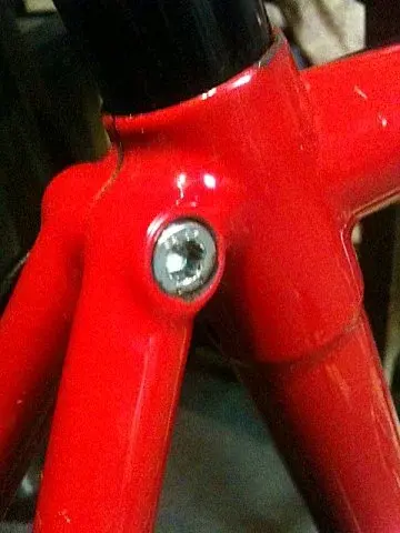

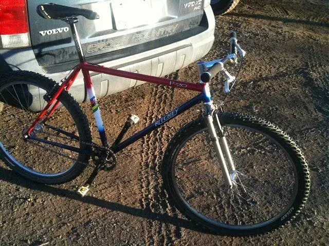

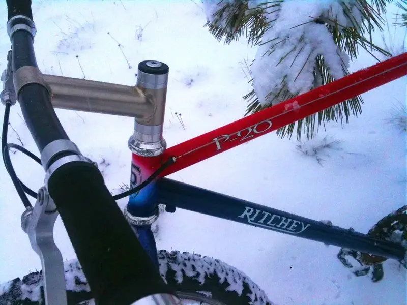

The P-20 evolution continues.
Luckily I had a threadless 1" Tange fork on hand which fits the frame nicely. Also found a steel stem and wide bar to sort out the ergos.
The snowy trails made for difficult riding but so far the stretch and bar drop feel good.
Next step is to trim the steerer and swap out the wheelset.
Good choice ditching the IRD.
Mine was about as rigid as an overcooked noodle. It made my Alan 'cross fork feel like a Klein Strata in comparison.
The IRD definately has some flex going on but the real issue was it being a non-sus fork on a sus-adjusted geometry.
Short fork on a steep angled bike made for some tricky handling.
Still, that IRD is one nice looking fork!

That a short head tube try stacking spacers under stem.
Be easier to sell the forks should yiu d
Ever do that.
