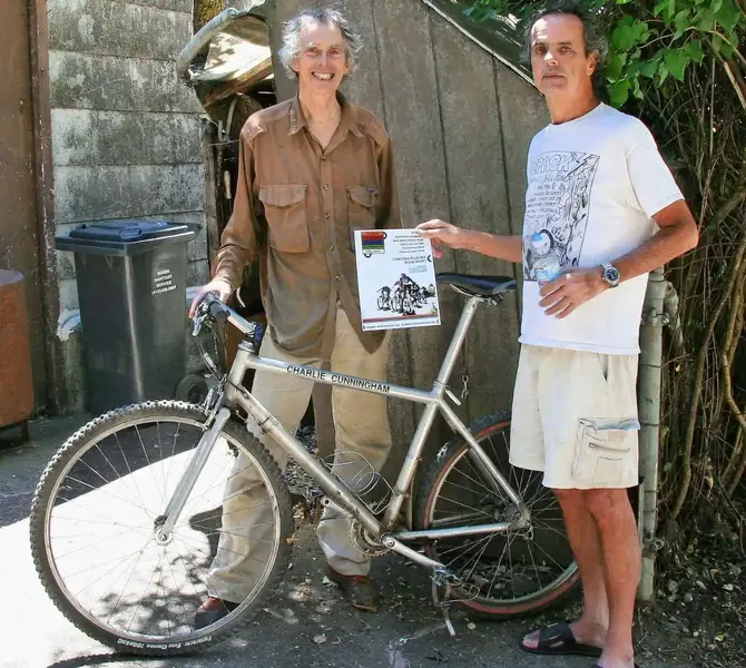

I agree with Stevo-try it-you might like it! Here's a pic of Charlie Cunningham and me from a few years ago publicizing the OWMTBC. His daily rider in the pic. is one of his older frames, originally designed for 26 inch wheels-now sports a longer fork and 29 inch wheel and tire. He says he likes how it handles.
