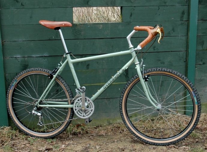

Hmm, now you say it I can see what you mean.
It could be a few things,
Argos have sorted the frame so I am pretty sure that is OK.
It could be the picture, you can see it is not straight on as both legs are visible from the side.
It could be the forks, they have been crimped on the legs where someone has at some point over tightened them. They may not be %100 straight out of the crown (if that makes sense)
It may just be that the rake of the forks is insufficient for the frame? Overburys did use straight bladed forks on occasion but I believe they may have kicked forward slightly (like switchblades).
Any other opinions out there, I may have to consider at least trying some different forks, :roll:
I've been looking at this again and again and it really does not appear right :?
Is the crown of the forks the right way around?
It looks as though unless you have tiny feet that you would get toe overlap using them ...... hmm :?
Could the forks be bent too? Would seem a highly unlikely misfortune but ....
The problem with all the side on views is no 2 are the same as mine. BUT. Generally I am thinking the pace just don't have the rake needed to push the front wheel forward like the others.
Maybe. . . :roll:
I have seen a Roberts with rc30's on where the geometry is similar to this mind.

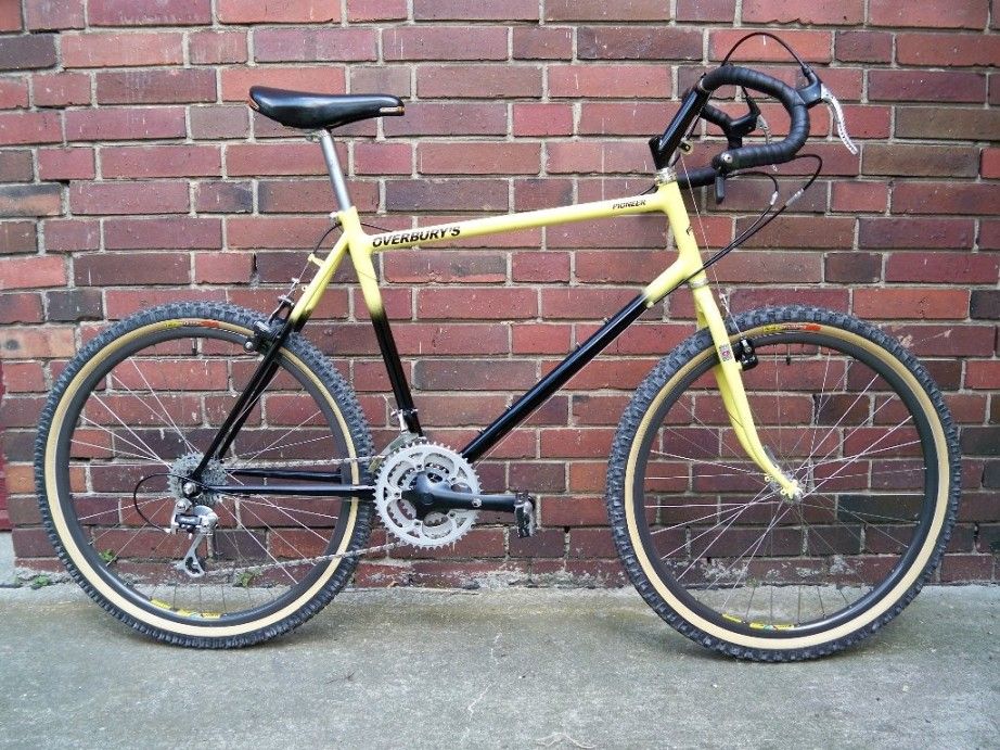

Maybe. . . :roll:
That's the Roberts thanks LGF. Is similar to my eye, other than being a smaller frame. The front wheel is a similar distance from the downtube.
As for the fork length, the headset and crown race aren't properly installed yet so that may make 2-3mm of difference.
I have installed the legs so they are flush with the top of the crown. Is this correct?
