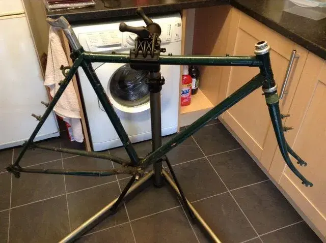

Although the forks have a different rake, I cant find anything else to match the headtube cable guides.
* and those rather unique roadie style semi wraparound stays. So I would suggest a late model Peak Finder/ Crossfell from around 1986

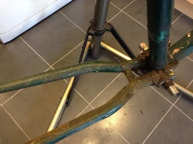

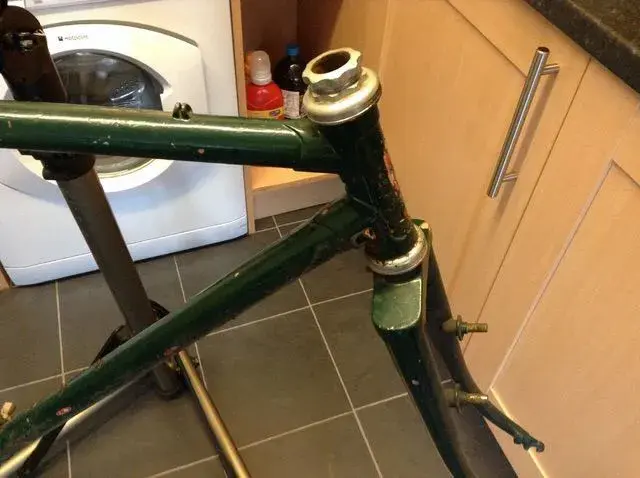

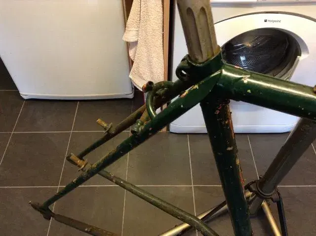

Bike was delivered today.
So I decided to strip the bike.
The gears and brakes look great, the brake levers are good, but the gear levers are horrible. So I will be on the lookout for a pair of shimano m700 gear levers.
And the bullmoose bar is really nice.
But I have a big problem, the seatpost i stuck.
I have never bought a bike yet with a stuck seatpost. But there is a 1st time for everything.
And also the green paint is horrible. It look like it was brushed on.
If anyone has a good solution to my stuck seatpost, give me a shout please.
