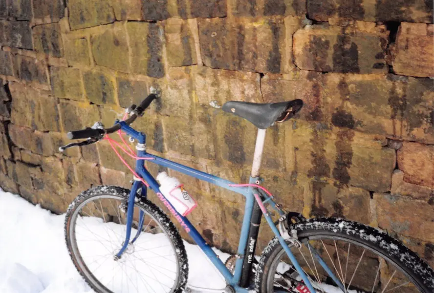

There was no serial number on either of my bikes - both were Columbus but there were plenty of Reynolds frames. Tubing can have a faint Reynolds marking once you get the paint off.

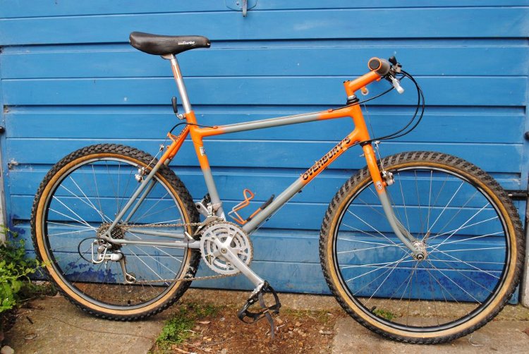

Heres another colour option - sadly this one looked like it had a front end impact

Thanks LGF,
Its good to know that missing s/n are not uncommon.
I'll definitely be going for a fade of some sort. No firm plans yet but it's likely to be fairly bright 88/89 stylee.
The person I bought it off said that the bike was yellow & blue (I haven't seen any blue yet)
He also said that he bought it off an American who'd had the f&f imported to the US to be built up, then later brought to the UK.
