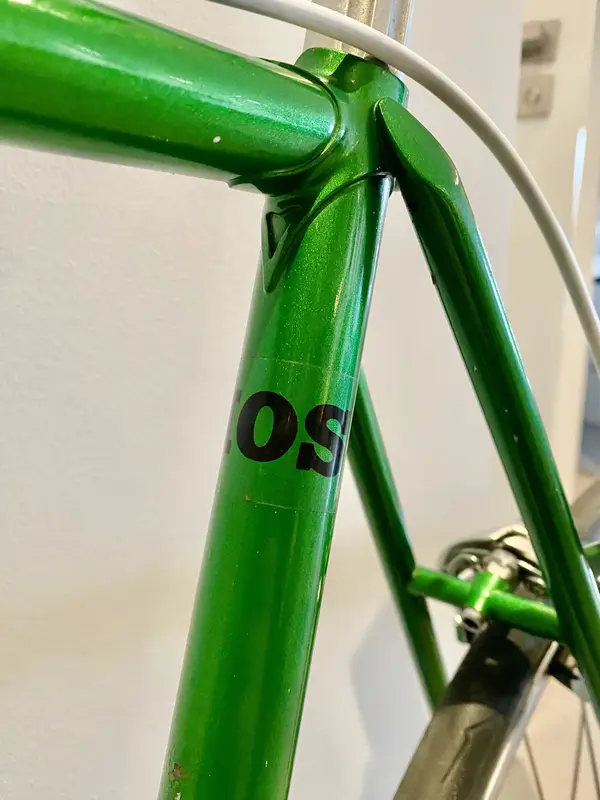

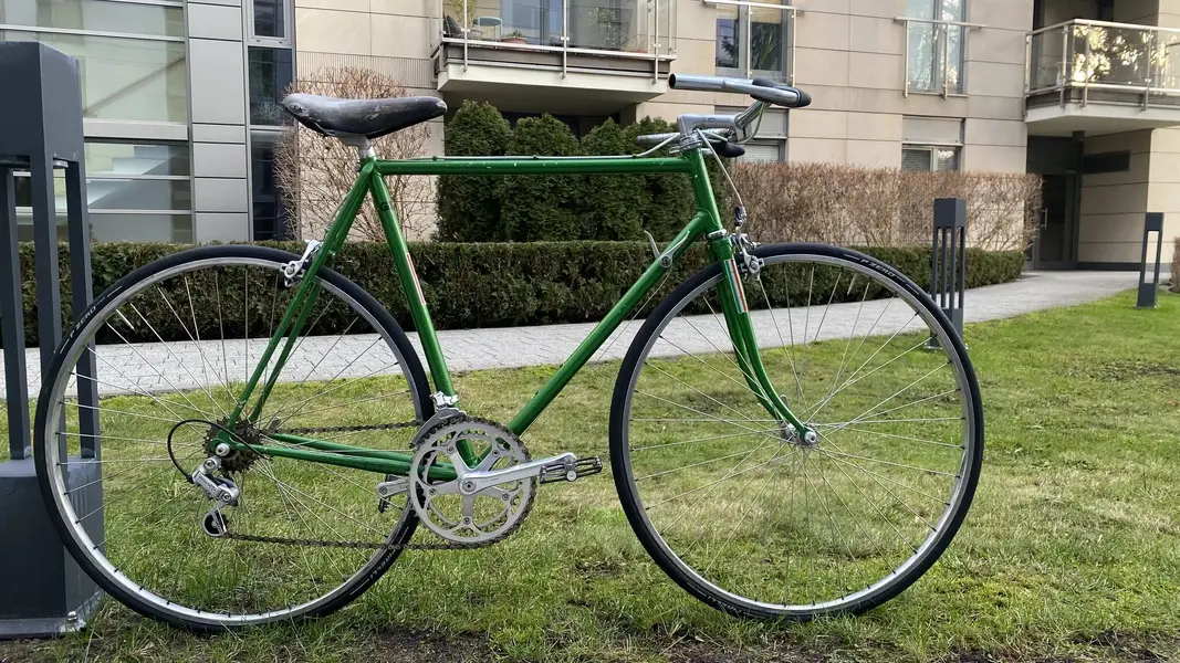

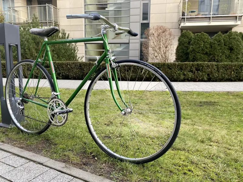

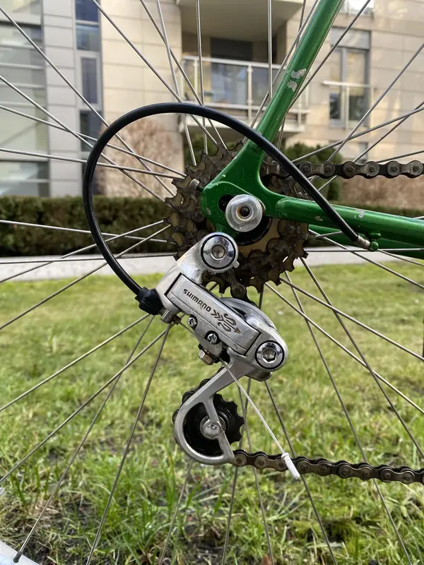

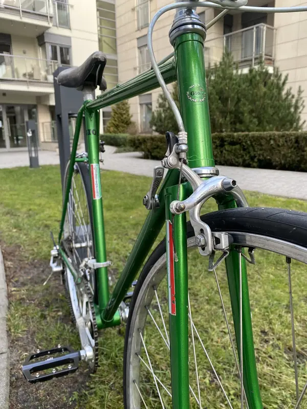

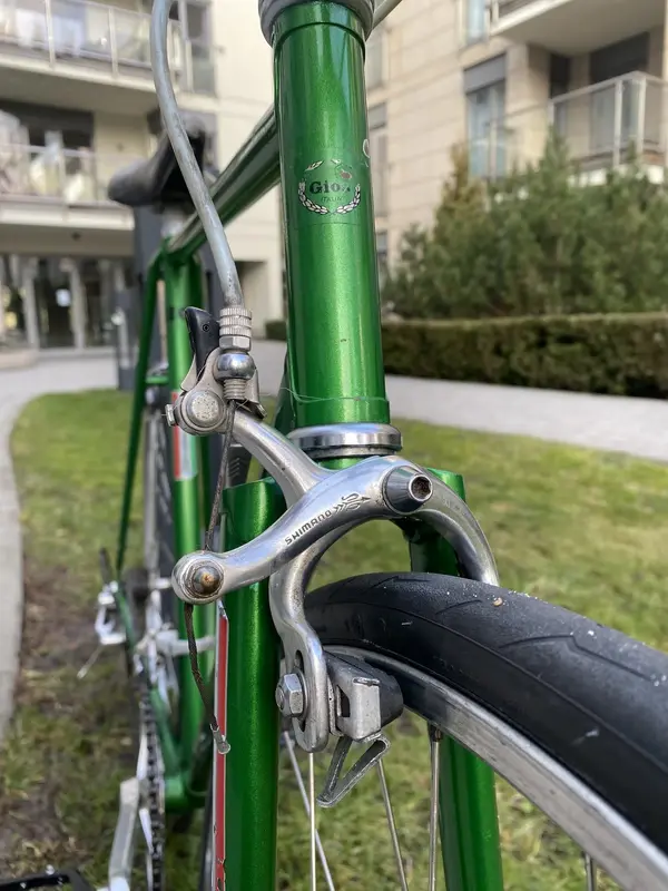

I’m new on the forum. My name is Chris and I’m looking for help in defining the brand of the classic road bike.
I’ve bought it in December in Poland for 70 pounds. I was told it is Gios, but when I started to service it I also started to have doubts.
The challenge: the frame - lugs have unusual shape for Gios, and cable are routed on top tube with full rings. Moreover the colour is not matching any Gios official guidelines.
I’m aware that handlebars and Shimano Golden Arrow might be not oryginal, but the main question is about frame brand.
I’d like to give it a new look, so any help is appreciated. Thanks!! IMG_8601.webp

Welcome to the forum!
Fine job with the photos.
Resembles no GIOS example have ever seen...and have been at it for over fifty year...
Typically a GIOS frame will have some signature points such as seat stay caps, fork crown, shell cutouts, etc.
Transfers appear to be aftermarket.
Another reader may have some ideas as to what it is.

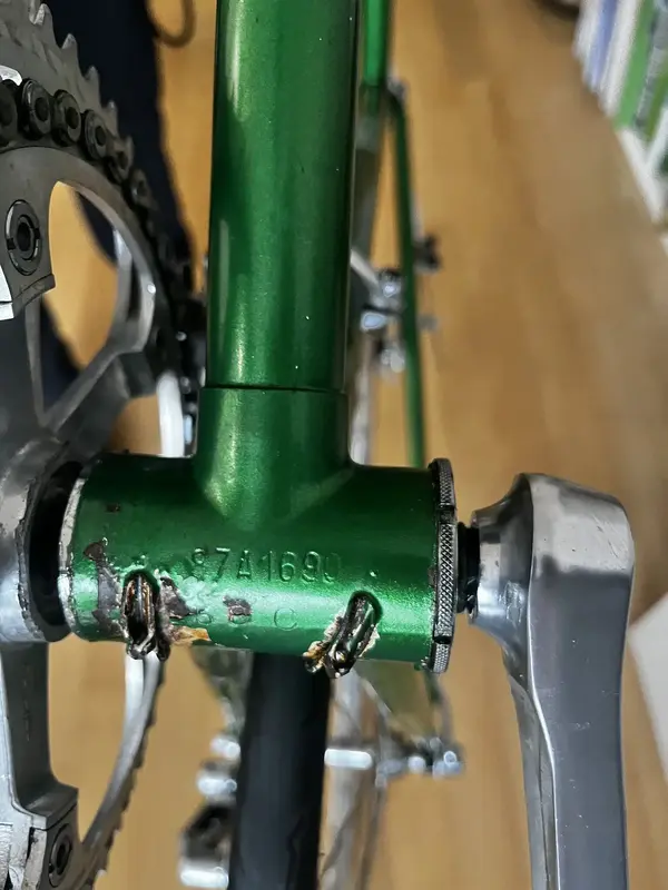

Are there any markings on the bottom bracket shell? A serial number perhaps? What is the diameter of the seat post?

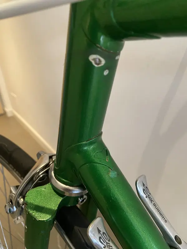

It looks like a well-made but rather generic mid-range frame. One clue might be the fork crown. Not a very common shape. I don't recall having seen it before.
The 105 'Golden Arrow' group is really nice. That alone is worth the 70 quid, IMO.
Enjoy the bike!
Hey! Thanks for help! This is probably the serial number
87A1690
Sorry for a photo quality.
I bought it mainly because the Shimano Golden Arrow is in great shape. As well as BB and Campagnolo headset.
It is hard to believe that someone made this bike a fake Gios, and put a great hardware like this, isn’t it?

serial format is consistent with one employed by the Cesare Rizzato firm
possible it may be one of their products...
do not wish to assert an identification

As @juvela so subtly points out I must have seen that fork crown before. And indeed I have. On my very own Atala ...
Details are similar, but not entirely identical:
Tubing is by Falck:
I wish I could say mine was cheaper than that faux GIOS ...
