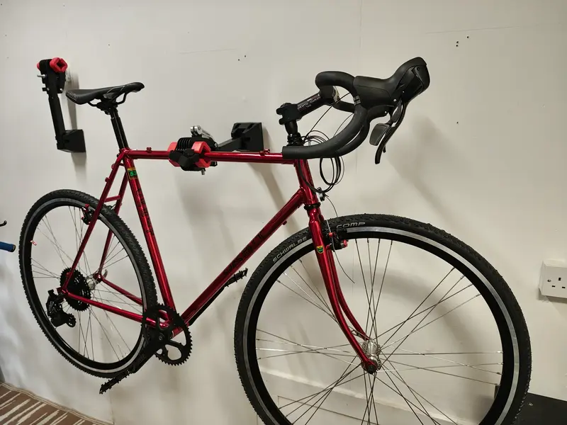

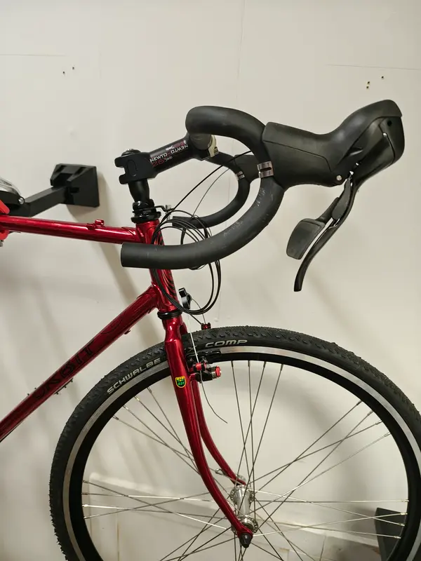

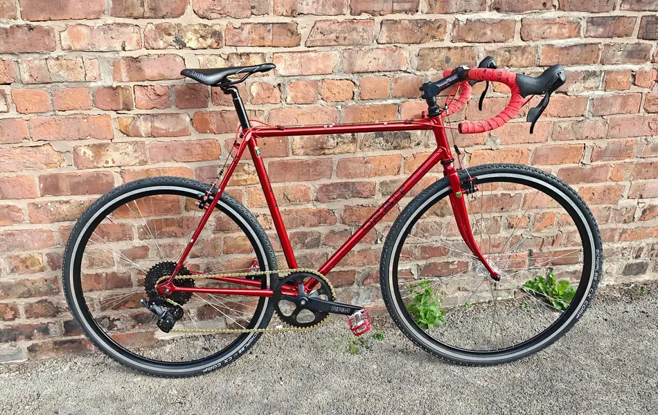

did some rummaging in the workshop today and found a Deda Newton stem and some Piega Elementi bars, plus some ti bolts to make this combo lighter than the Ritchey bits and a bit more classic shaped - I think you did me a favour there ;-)
