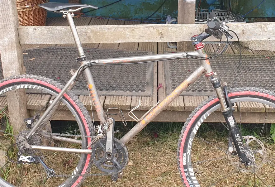

Almost exactly like mine, a year earlier maybe in that your seat tube has a sleeve at the top and the pace forks have the chrome brace on the back whereas mine had a cast and machined alloy brace on the back - cooks rather than topline, ritchey rims, xtr gearing... did it come like that new?

I built mine up from bits collected, originally most of those parts were on an Orange Prestige but when the Vit T turned up I knew I had to buy it!
I was lucky enough to have a Ti Merlin too at the time, actually preferred the ride of the Merlin which was also set up with Pace, Cooks, XT/XTR mix but, the frame finish on the Vit T was much more interesting to me.

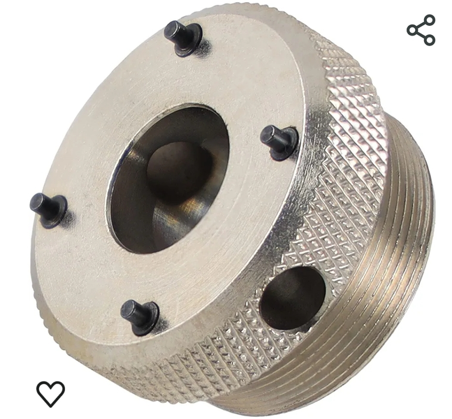

Mechanically speaking, the 970 had a funny splined end like Octalink, needed a special tool to remove a flimsy plastic collar, and then screw in to use the crank fixing bolt as an extractor on the left hand crank...
Lucky it's there in one of the shop's 4 boxes of crank extractors🤣

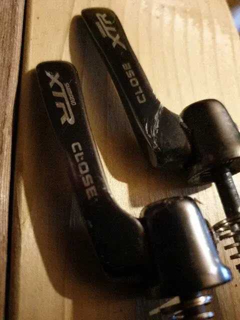

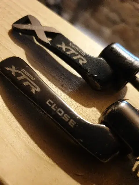

Mildly inappropriate m980 skewers to fit on my m960 wheels. IMG_20240925_161924.jpg
Because I've gone for the "exy" look with the chainset and dérailleurs Screenshot_20240925-164404_Firefox.webp I've extended this to the skewers.
Now should I sell the 960 skewers to pay for the 980s, or keep them with the wheels for future collectors?
