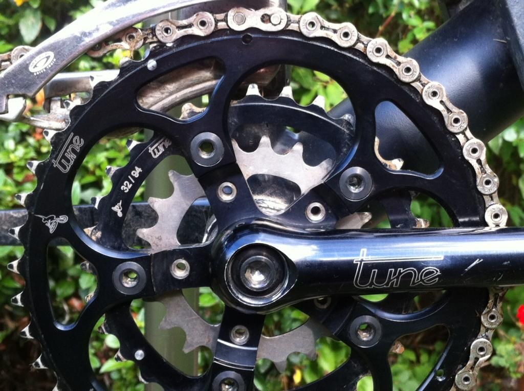

Can't resist showing a pic of the new stealthy Tune Bigfoot and rings.....

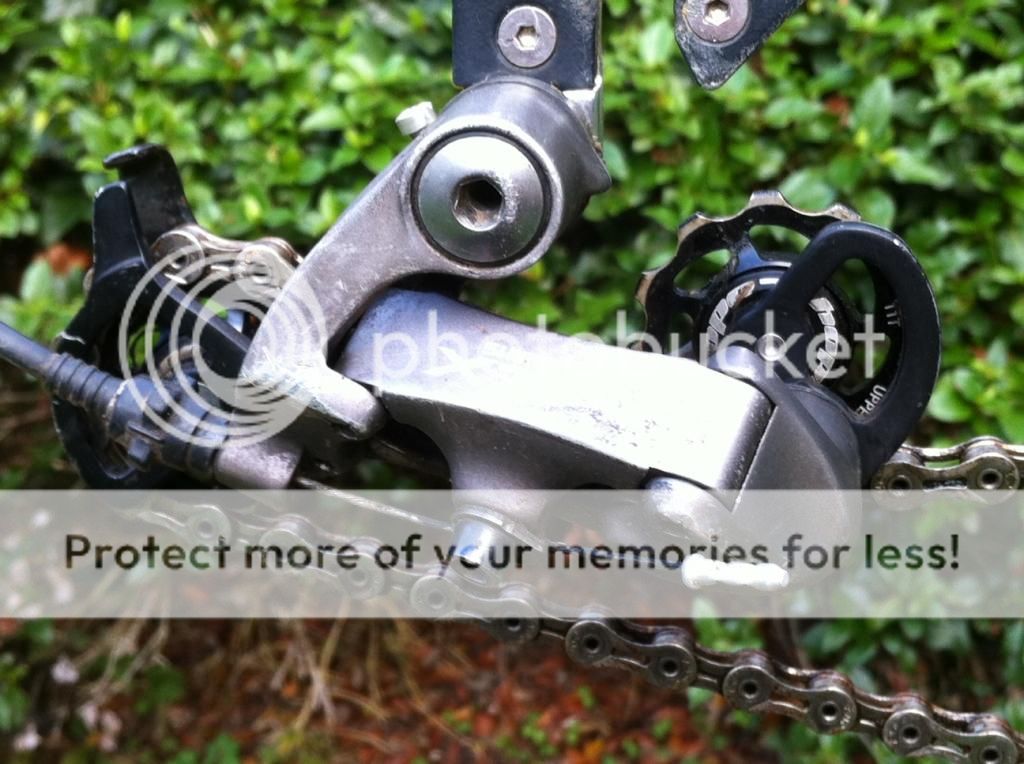

Jockey wheels were looking pretty stuffed - so new black Hope items...
Black Ti crankbolt & outer chainring bolts - Tune 22T inner ring - with Ti bolts
I'll probably go 2x9 on this in the near future :)

Given that I didn't ever seem to use the granny ring..... I thought 2x9 would be an option.
As I've been running a Dura-Ace 27-12 cassette - I reckoned a little more range might be in order.
So the race wheels will shortly have a new XG999 cassette!
32-11 and only 173grammes - a thing of beauty!
