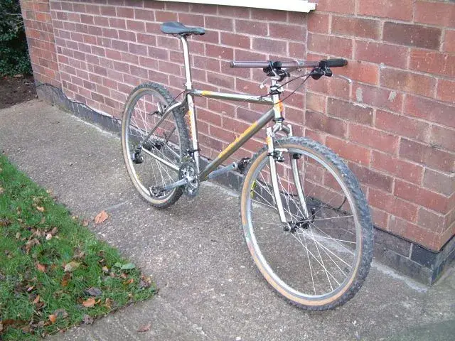

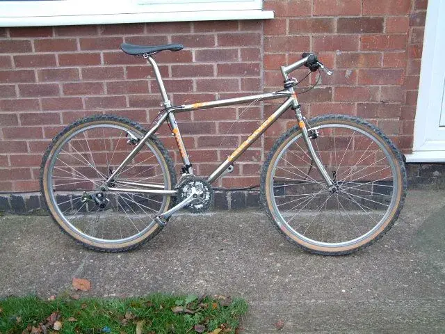

I'm rebuilding a P7 & using some better bits from my C16, I've just spent 20 minutes sorting out the 8 speed shifter, but when I came to swapping the rear cassette as the C16 had good LX/mavic wheels but 7 speed, I found the original P7 owner had been running a 7 speed cassette with a 8 speed shifter? strange, I now need to buy a 8 speed cassette.

That's another nice Nickel P7. 8) The 17" Orange frames look so right, especially with F7 forks.
I think I'd stick with LX mech's if it was mine since that's the original spec. and the bike is so unmolested otherwise.
They could be specified with an XT groupset when new though, so there's no 'right' answer.
Cool bike. :wink:
Nice-looking bike obviously, and some of the best forks ever, but I personally wouldn't say a P7 was necessarily 'better' than a C16R. Heavier-duty, I guess, but just depends what you want really.
Just guessing, but if the bike has a 8-speed shifter and a 7-speed cassette, is the high stop on the rear mech screwed in to prevent the shifter from being able to move the mech to the non-existent 8th sprocket? And apologies if it's obvious, but I just wondered whether he was running a 7-speed cassette because the wheel has a 7-speed hub? Still, nothing wrong with 7-speed IMHO.
