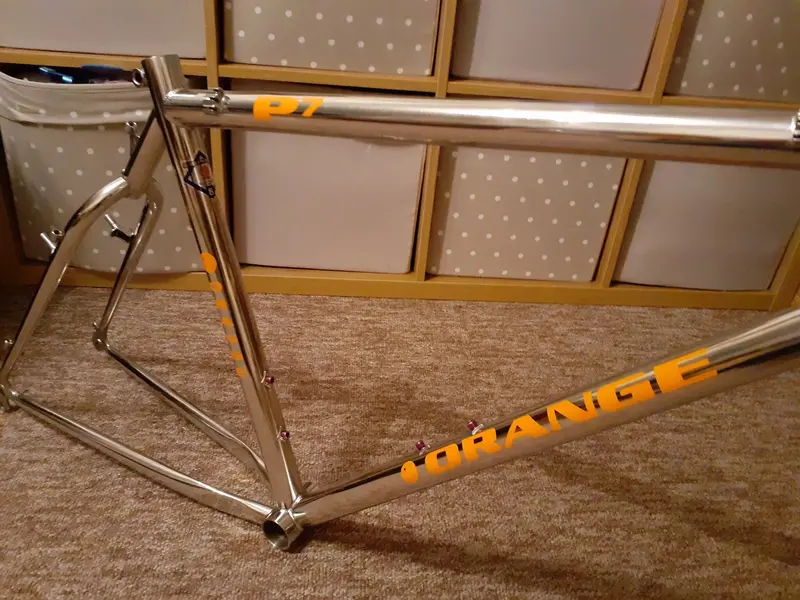

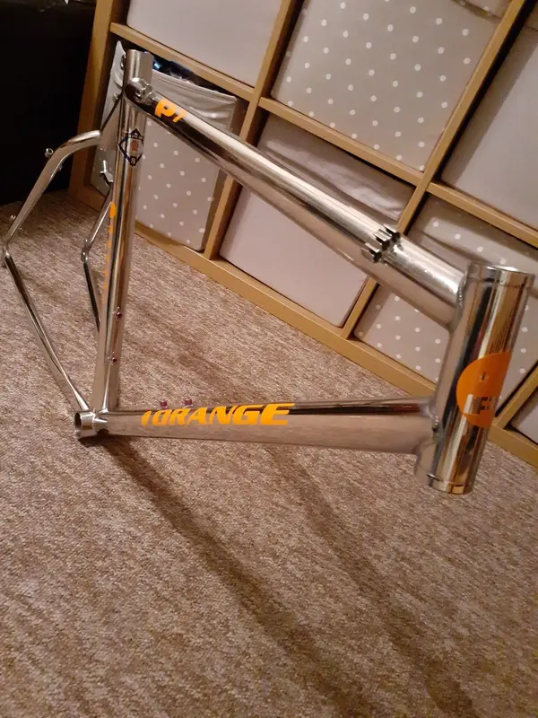

It's been a while since I've done a build thread for a bike on here so after many years away I decided to get myself a 'new' lockdown project to give my mind a break from my day job of working in critical infection control.
I've always been a fan of Orange bikes,and used them for my xc race duties bitd,so found a good project P7 to get stuck into.
Upon receiving the frame,I could tell this was going to be more then a quick polish and build,and after 3 weeks of stripping,sanding and polishing it came up a treat. As always,retrodecals supplied some great quality pieces to attach to the frame.

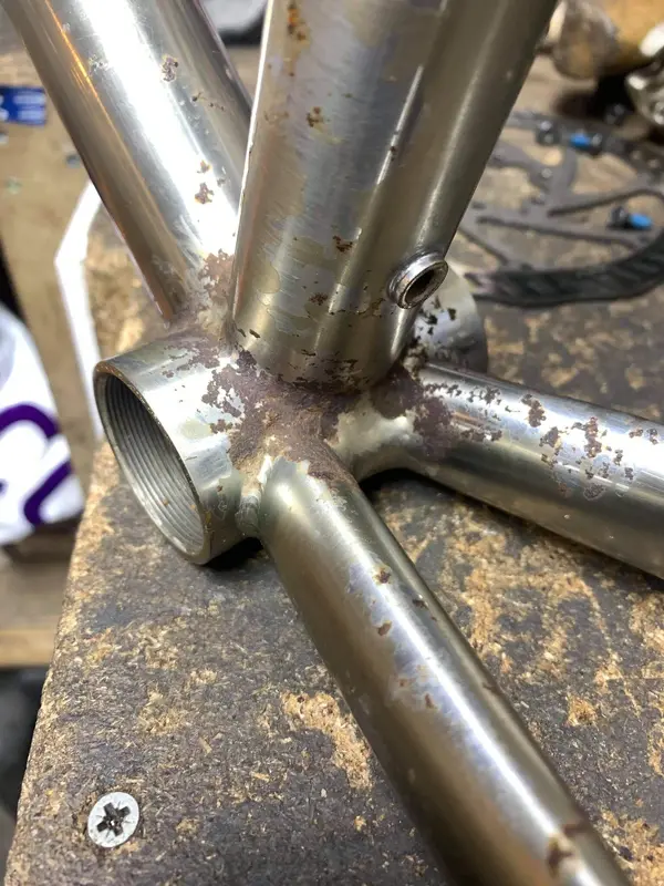

I’ve just got hold of a single speed p7 and it has similar rust issues! What’s the best way to tackle these? Can I literally just sand and polish it away?
thanks,
Jon
Here to also ask how you got the rust off and frame polished up so nicely?
Anyone have any advice for those of us without a fully stocked workshop?
Products; tools; process?
Wet and dry and patience?
Wax afterwards or clear coat?

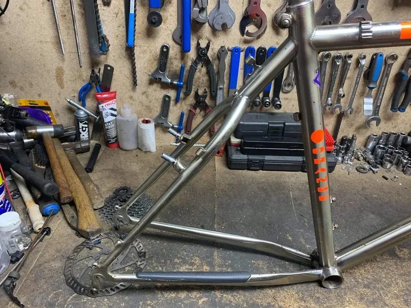

Here's a quick breakdown of how I did it....
* workshop pic not mine but who I got frame from*
Anyway,it started out quite rough and set out first using fine wire wool with wd40 to remove the lacquer followed by 240 grit wet n dry paper again using wd40,working through different grades(480,800 and finally 1200). Thoroughly wipe clean then used autosol to a high sheen. Finally,clean and fit decals.
Will then use autoglym super resin polish to seal
