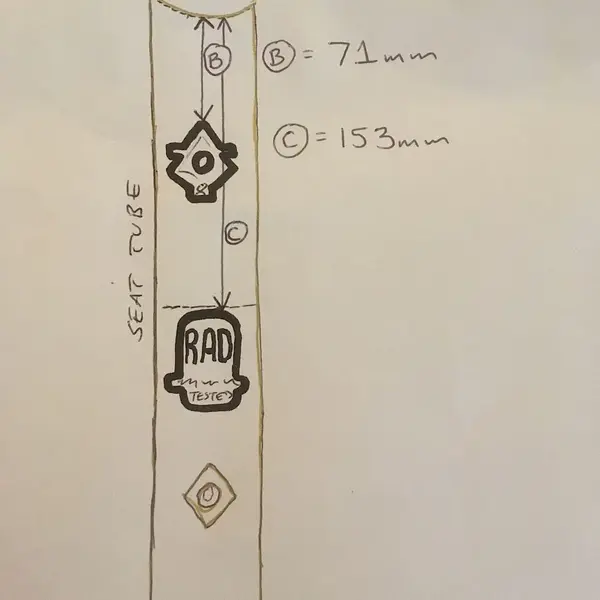

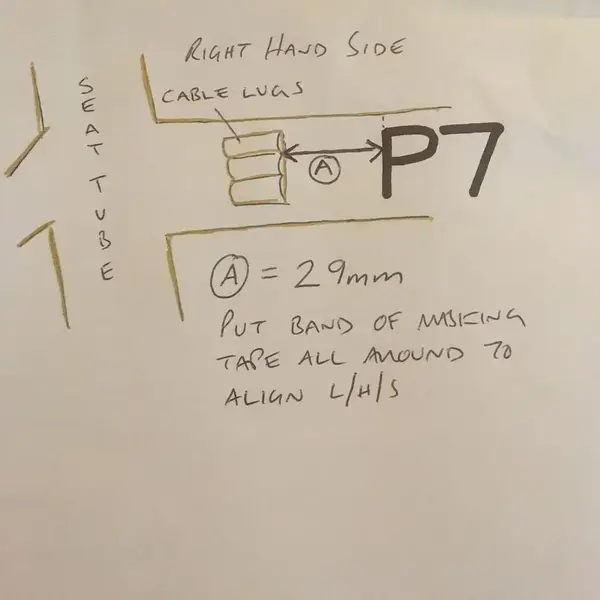

Here’s decal measurements taken from standard bike before I fettled it:
Link here to Build thread to assist with pics...
viewtopic.php?f=6&t=406573&start=30
Mine had metal head and rear stay badge but if you are replacing with decal versions which I think some came with (just a star on rear stay in decal form) then I’d use these same measurements...
Once you’ve got one side correct you can loop insulating tape around the start or end of the decal to perfectly align on opposite side...
Hope this all helps either now or years down the line if someone finds this...
Mine was a 19inch frame.
The downtube decal may differ on smaller/larger frames as you found below...

D = 37mm
E = 148mm
When I’ve resized some of the pics it’s chopped this off...
I’ll revise resizing tomorrow but it’s all here now.

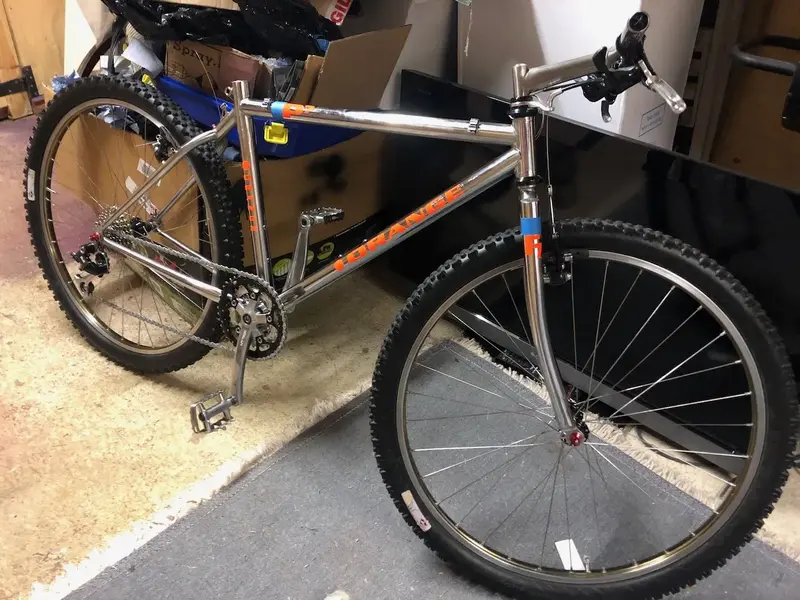

The top tube and fork positions were the same. The down tube was wildly different, I guess I never checked what size your frame was! However I had good photos so was a happy with what I needed to do all the same.
Shouldn't have done it at the time I did though. Condensation forming on the tubes as I got near them turned into a poor sticking environment. Good excuse to bring another bike into the house to warm up. Wife loved that :)

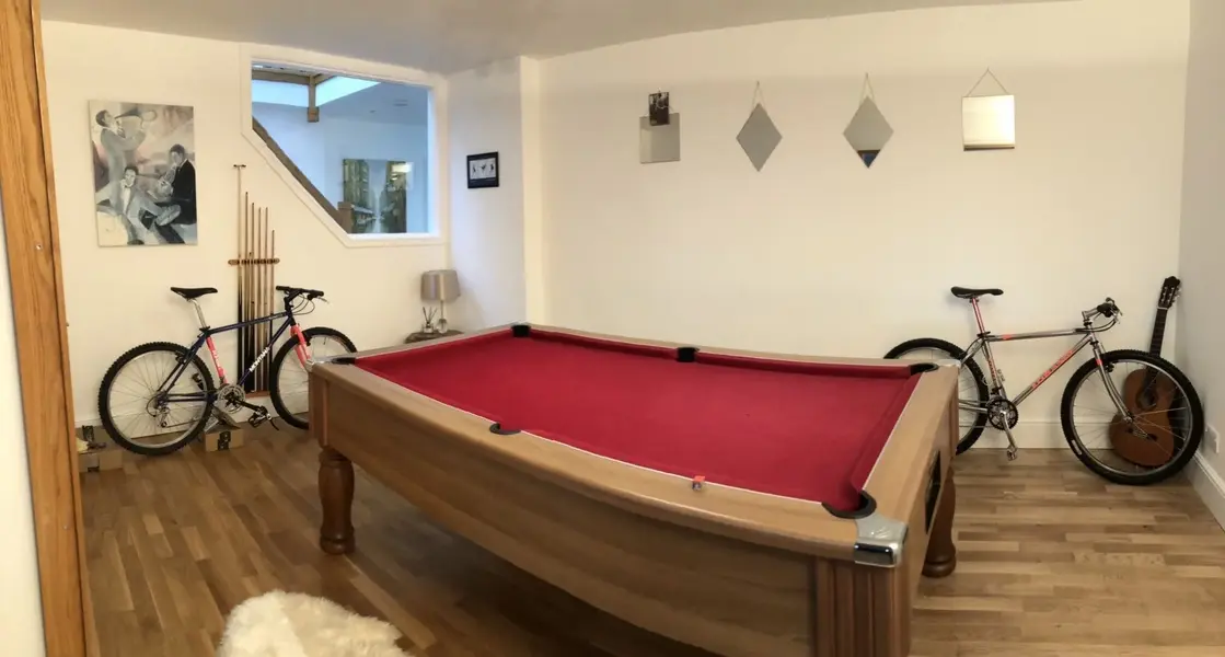

My daughter wanted a "fashion show" of the two bikes I've just finished that are currently living in the house. Will end this thread with an outdoor picture when the sun's back out, but for now...
