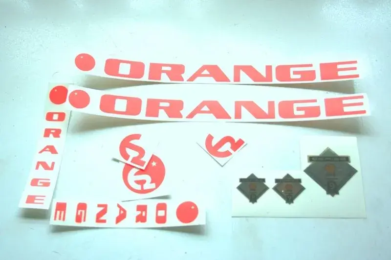

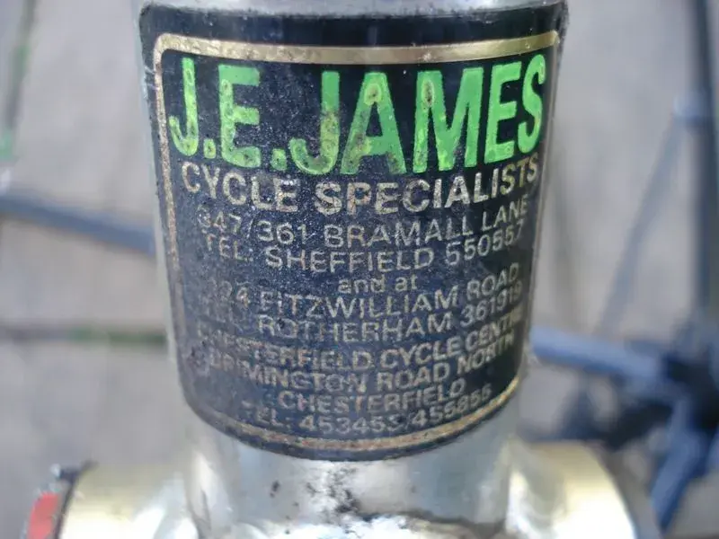

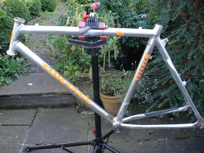

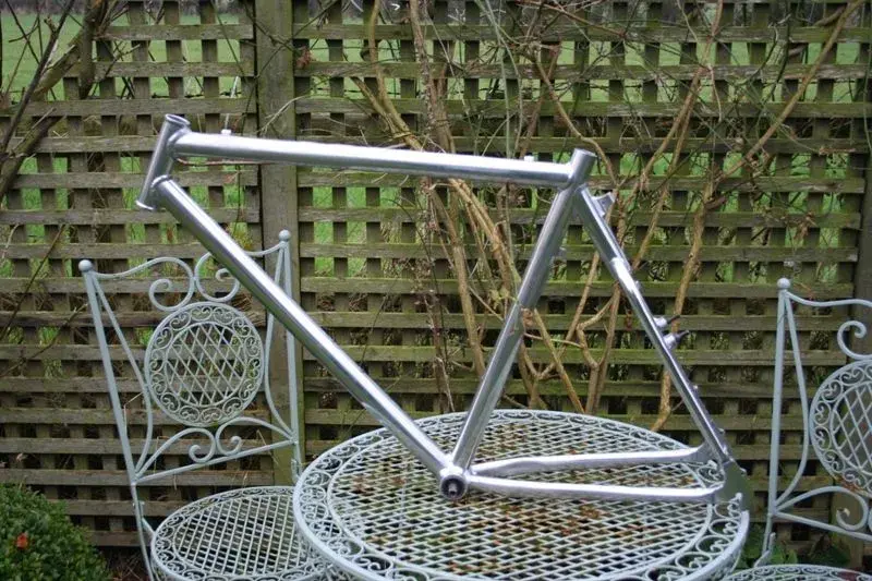

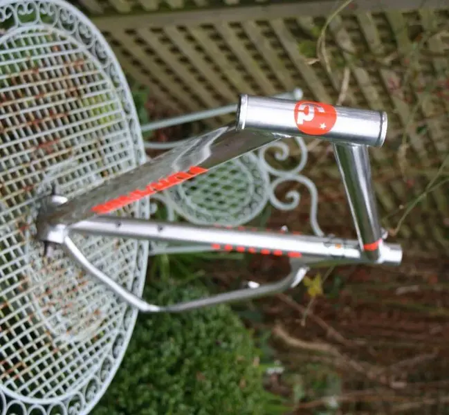

Looks good, glad I could help, its gonna look ace once built up, as all your builds do in fairness. :D Will follow with interest!!
Re: Orange E2: new project

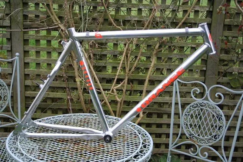

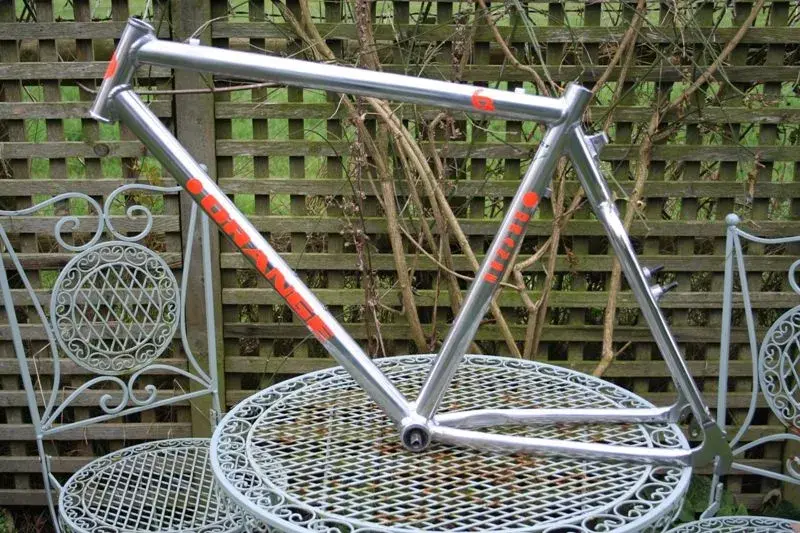

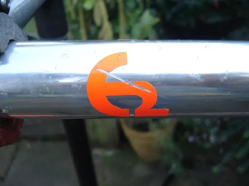

I was hoping to keep the original decals on it, but the frame has a lot of worming and a few scratches around the top tube.
So it will be a full strip down to the bare aluminium, then a fine wire wool with autosol. It's very time consuming but well worth the effort.

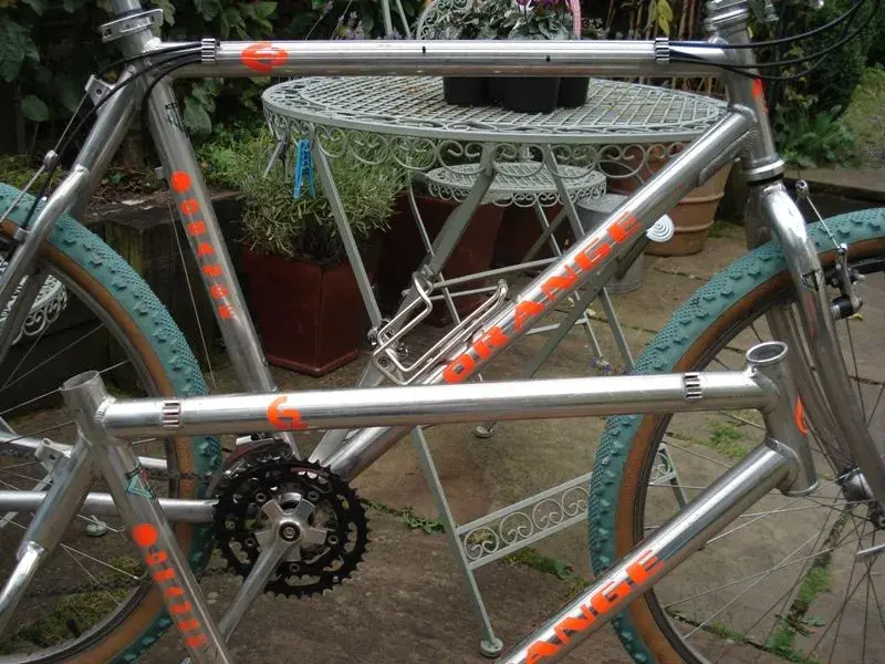

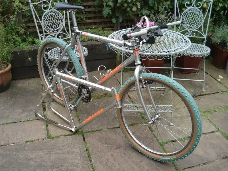

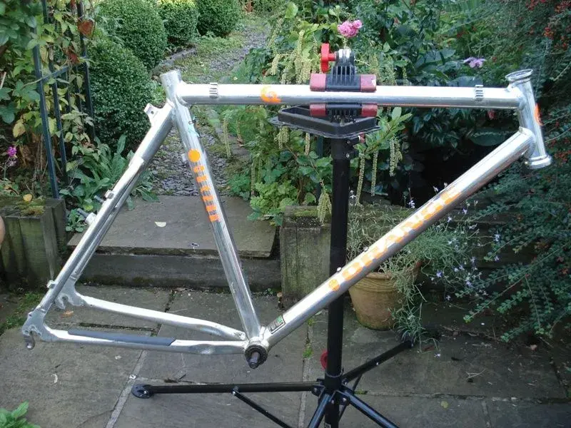

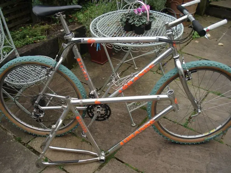

Re: Orange E2: new project *2020 UPDATE*
Cleared the laquer off and gave it some elbow grease. Just in time for my decals to arrive.
