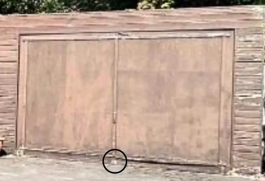

There is absolutely no way was that rear mech (or any other components) was added later. Just my mum and I lived at the house in Elland and, in 1998, my mum was 53 y.o and never rode a bike. No one else lived or had access to the garage and the garage door was knackered (it dropped off the runners and we didnt have the money to fix it). There was a risk that if we tried to open it, it would drop onto my Astra SRI, so I fitted a padlock to the exterior of the garage door to prevent that happening and then ended up losing the key.
When mum died I had to cut the lock off, to gain access and clear the garage.
Apologies for the poor quality photo, took it off the estate agents details but it shows the metal plate left on the garage, that secured the bolting mechanism to the concrete foundation at the front of the garage.
As mentioned, I was offered a job in Suffolk and relocated in February 1999, moving into a small rented cottage with no outside storage. I left everything at my mums and when we finally got a house with storage, bought a new bike. The Orange bike has been locked away from the end of 1998 until 2025.
