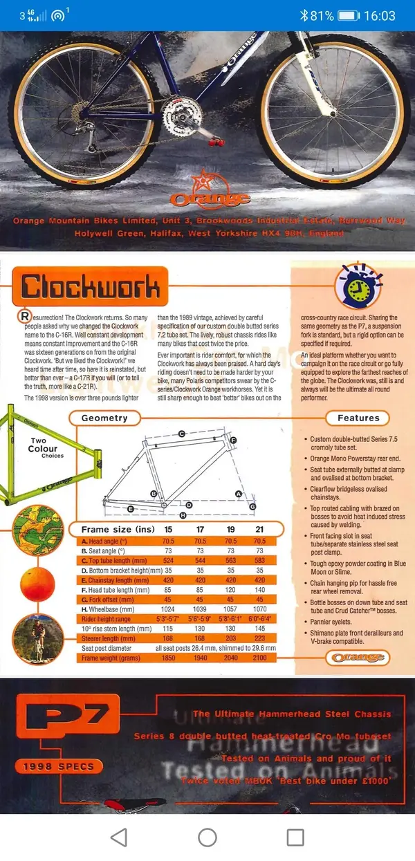

and that's a 1998 model frame from the serail number as it's made too late in 1997 (August) to be anything other.
It reads something like F708A042 from my best guestimates
Also if you look on the seatube badge, it will hopefully have series 8 tubing, whihc is a big giveaway. though you'll not know to look for that.
http://www.retrobike.co.uk/gallery2/d/3 ... ochure.pdf
Here are your other pics
The badge is for Series 7.5 tubing. You have the serial number right though
Thanks for attaching the brochure.
Series 8 was the P7. The linked brochure lists 7.2 for the Clockwork. However there may be a transition or typo as a larger 1998 catalogue I have list 7.2 in the blurb but 7.5 in the spec.
Best screenshot I can do on phone at mo.
