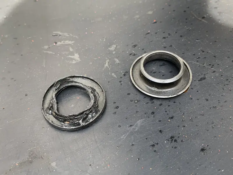

I was wrong about the bearing cover being on the outside. It was present on in the inside, just another on the outside for good measure šŸ™„ Anyway the wheel is fine, wants a single cone, some bearings and the freehub body hadn’t been tightened. Easy stuff.

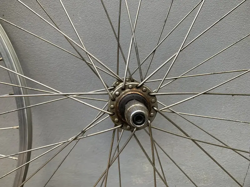

Mmm.. Just noticed that the 3 of the the 4 sides are built 2 cross. I’ll have to change it.
Leave as 2X, i have some two cross, you have DT DB spokes there too. There was a period of 3x/2x Rears (or people would take it further if building yourself 3x / radial rear.)
Be plenty strong and all the wear and tear is bedded in to that setup.
That and you'll need to stretch the spokes by 6mm
Yeah you’re probably right. They’ve made it 30 odd years so far like this and they’re tensioned up lovely. A good clean up for them today then is in order.

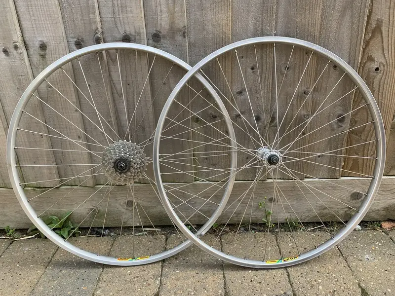

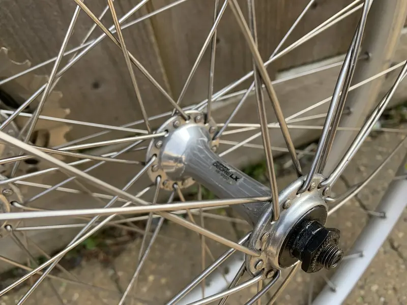

Hubs all serviced with new bearings and some cones from donor LX hubs. Cleaned the wheels up too. That front wheel was a pain to clean but got it pretty nice, I’ll give them another look over before tyres go on.

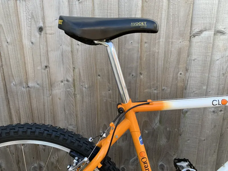

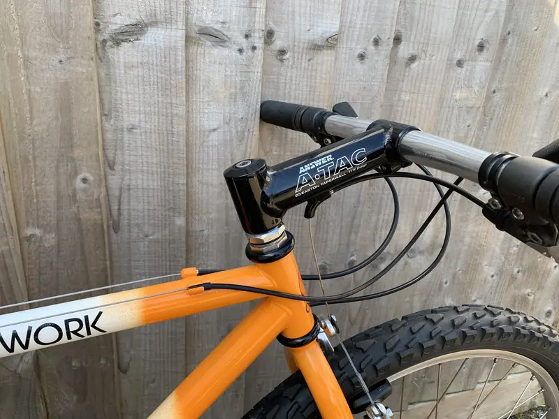

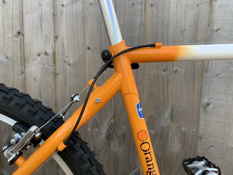

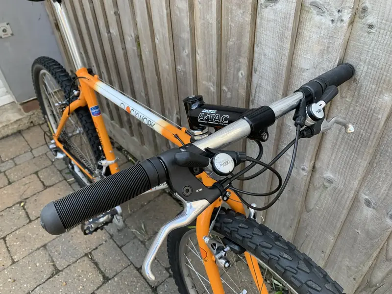

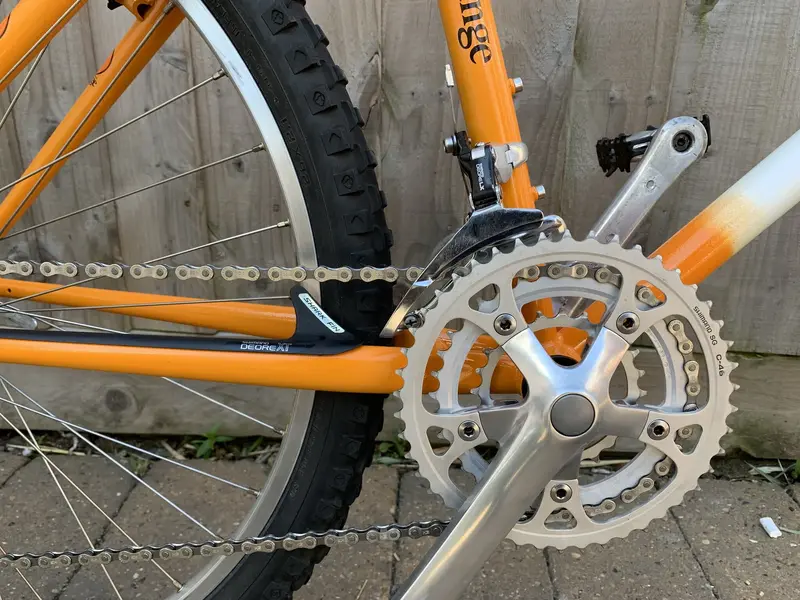

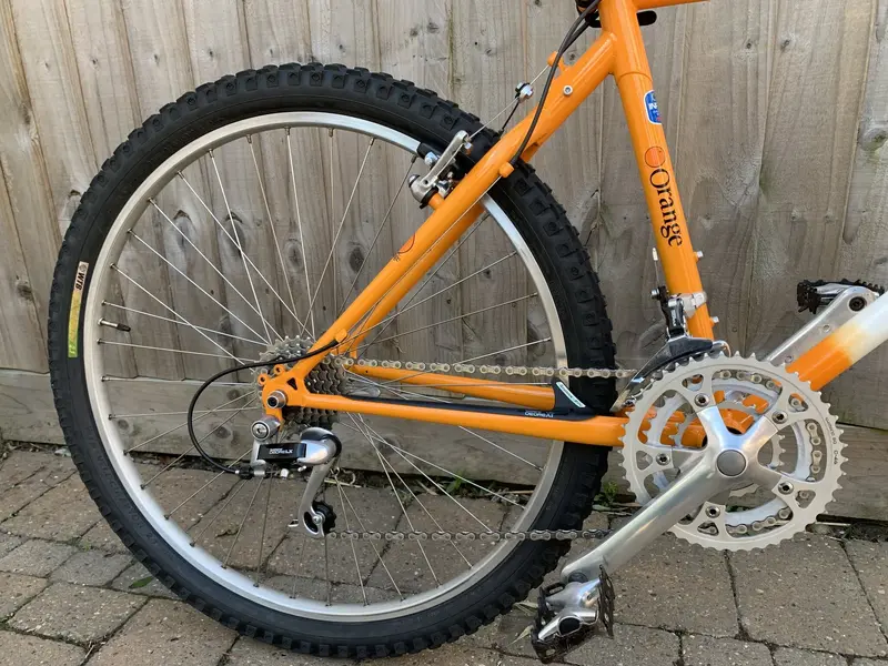

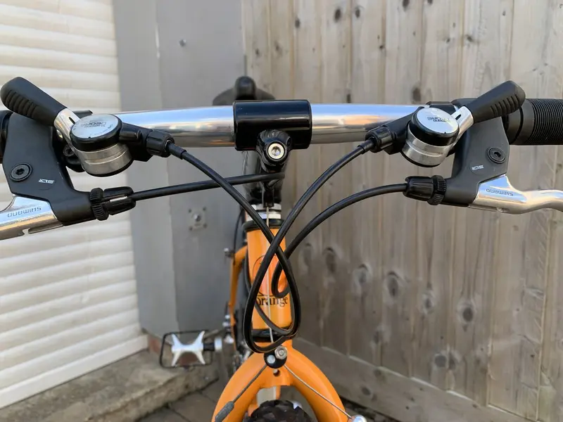

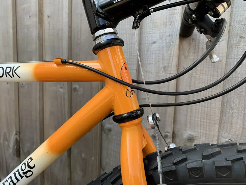

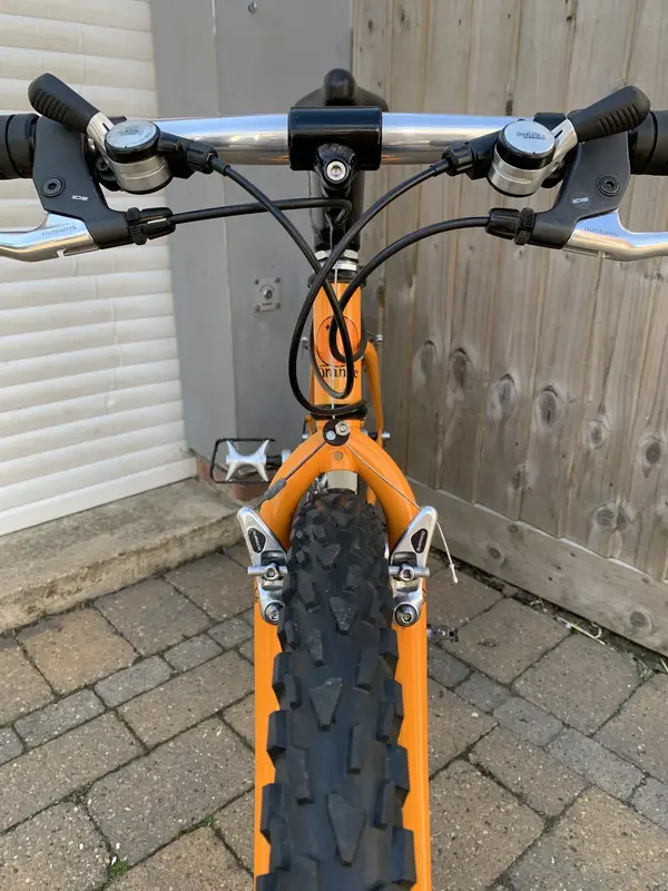

99.9% finished. I’ll get some nicer pedals and just want a couple of crank caps.
